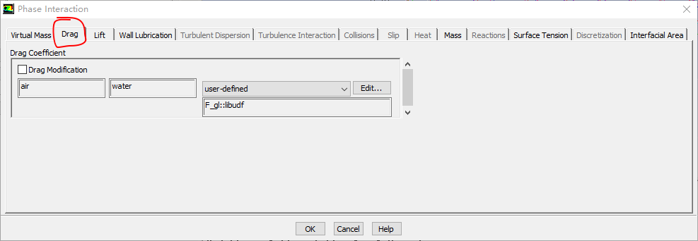

    fluent默认模型收敛,修改后直接发散。提示:
    Updating solution at time level N... done.
      iter  continuity     u-water       u-air     v-water       v-air      vf-air     time/iter
    # Divergence detected in AMG solver: mp-x-momentum -> Decreasing coarsening group size!
    # Divergence detected in AMG solver: mp-x-momentum -> Increasing relaxation sweeps!
    # You may try the enhanced divergence recovery with (rpsetvar 'amg/protective-enhanced? #t)
    # Divergence detected in AMG solver: pressure correction -> Turning off correction scaling!
    # Divergence detected in AMG solver: pressure correction -> Increasing relaxation sweeps!
    Error: Divergence detected in AMG solver: pressure correction
    Error Object: #f
    这种情况是因为曳力突然为0了,或者无穷大?????那位老司机教教我
    怎么修改的模型?
    zousiyuZ 2 条回复 最后回复

    @东岳 计算了新的曳力系数
    #include "udf.h"
    DEFINE_EXCHANGE_PROPERTY(F_gl, c, mixture_thread, second_col, first_col)

  • zousiyuZ 离线
    zousiyuZ 离线
    zousiyu
    @东岳 老师有什么意见吗?
    不懂Fluent,不过43行代码之前
    K_gl = (void_g / (void_g + void_l)) * (tmp_1 + tmp_2);
    是不是放后面比较好?然后void_g + void_l不应该等于1么?
    zousiyuZ 1 条回复 最后回复
  • zousiyuZ 离线
    zousiyuZ 离线
    zousiyu
    @东岳 谢谢,这个错误我已经发现了。问题已经解决了,因为void_g会为1,那么1-void_g就是0,然后会产生NaN错误。
    我直接把void_g为0的情况强制修改为0.5了
    我更喜欢变成 void_g = void_g + 1e-6 :mianmo:
    waltenW 1 条回复 最后回复
  • waltenW 离线
    waltenW 离线
    walten
    @东岳 同意,我一般都是改成 + 1e-08
