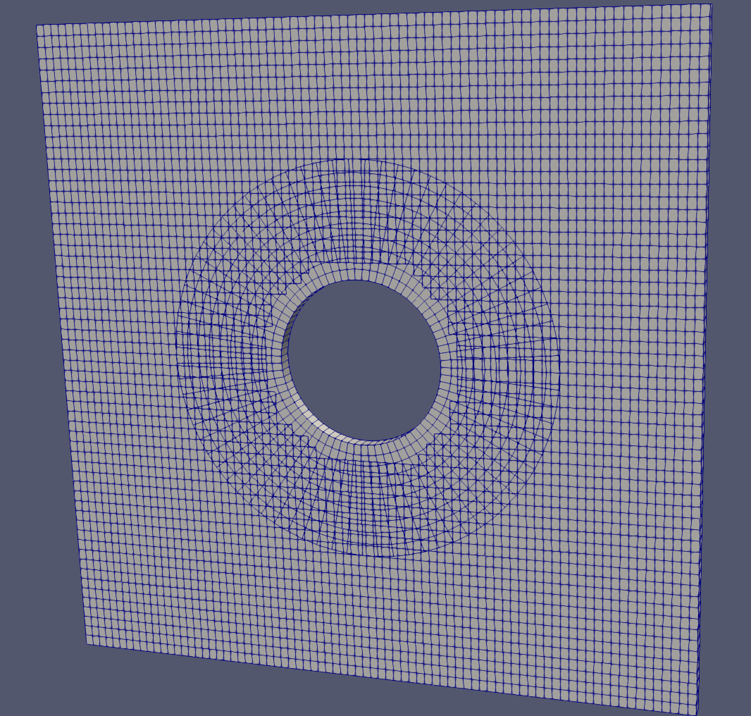

    @队长别开枪 你好。overPotentialFoam中有一个cylinder算例,但计算结果并没有cellTypes变量,因而无法区别网格的类型,在哪可以定义cellTypes并让其输出啊?
    我试了overSimpleFoam和overPimpleFoam求解器均有cellTypes,但不知道这个是在那定义以及如何定义的。希望能告知一下,谢谢!
    动边界
    队长别开枪队 1 条回复 最后回复
  • 队长别开枪队 离线
    队长别开枪队 离线
    队长别开枪 超神
    在 中回复了 我是河滩 最后由 编辑
    #21
    @我是河滩 There is no Chinese input tool in my Linux workstation, so I replied this in Eng. Take plus 1812 version for instance. It is simple if you prefer to write cellTypes field in the solver of overPotentialFoam, just add mesh.write() to the end of overPotentialFoam.C, i.e.,
        p.write();
        mesh.write();    // Add this
        runTime.functionObjects().end();
    mesh.write()will call the member function Foam::dynamicOversetFvMesh::writeObject() where cellTypes and zoneID fields have been defined. They will be written to 0 time folder in overPotentialFoam.
