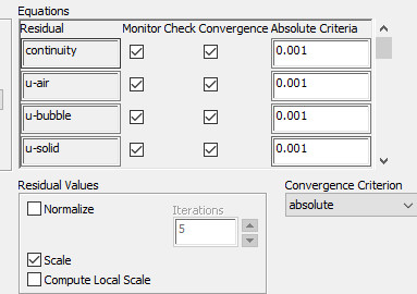

    今天看文献,偶然看到这么一句话
    然后我打开了fluent残差的设置面板,默认设置为:

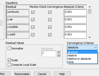

    Convergence Criterion 里默认是 absolute,然后下拉菜单有;
    而文章中所谓的 “the relative error between successive iterations” 到底属于absolute 还是 relative呢?
    fluent用户手册里对两者的定义分别是:
    absolute
    is the default and is available for steady-state cases. The residual (scaled and/or normalized) of an equation at an iteration is compared with a user-specified value. If the residual is less than the user-specified value, that equation is deemed to have converged for a time step.
    relative
    is where the residual of an equation at an iteration of a time step is compared with the residual at the start of the time step. If the ratio of the two residuals is less than a user-specified value, that equation is deemed to have converged for a time step.
    absolute是将该步计算所得值与给定值(初始化值?)进行比较所得的残差;relative是当前时间步长所得残差与初始时间步长所的残差的比较值。
    那么文章中所指到底是哪种残差?还望各位大神不吝赐教~
