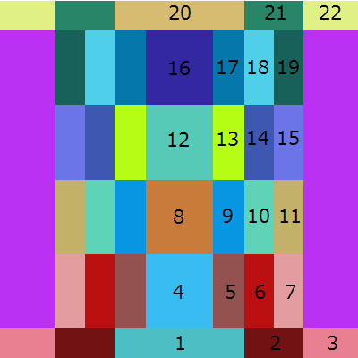

    如下图所示,模型被划分成很多个区域(每个区域包含很多个网格),我想知道每个区域的面积或者(体积),除了手算外,OpenFOAM是否有什么办法得到每个区域的面积(或体积)?最好是functionObject或者utility的办法。期待大佬们的回复,多谢!(备注:这些区域我是通过toposet划分的)

    我在网上见到的代码,你试试:
    const cellList& cells  = mesh.cells();
    const vectorField& faceAreas = mesh.faceAreas();
    List<bool> outsideFaces(faceAreas.size(), false);
    forAll(mesh.cellZones(), zoneI)
        const labelList& cellLabels = mesh_.cellZones()[zoneI];
        outsideFaces = false;
        // mark all faces that are NOT internal to the cellZone:
        forAll(cellLabels, i)
            const cell& c = cells[cellLabels[i]];
            forAll(c, cFaceI)
                const label faceI = c[cFaceI];
                // xor operation
                // internal faces get marked twice, outside faces get marked once
                if (outsideFaces[faceI])
                    outsideFaces[faceI] = false;
                else
                    outsideFaces[faceI] = true;
        // now calculate the area
        scalar zoneOutsideArea = 0;
        label  zoneOutsideNFaces = 0;
        forAll(outsideFaces, faceI)
                zoneSurfaceArea += mag(faceAreas[faceI]);
                zoneOutsideNFaces++;
        Info<<"zone:" << zoneI
            << " nFaces:" << zoneOutsideNFaces
            << " area:" << zoneOutsideArea << endl;
    https://www.cfd-online.com/Forums/openfoam-programming-development/69661-how-compute-cellzone-volume.html
