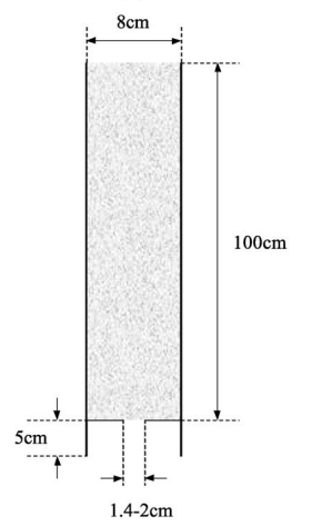

    各位大佬们好!
    我想画一个料仓,大多数文献模拟都对出口和进口不设置具体边界。但是这样我的几何体就不封闭了,无法正确生成网格,这种情况该怎么设置呢?还望各位前辈指点
    来自文献的例子!(Analysis of a frictional–kinetic model for gas-particle flow)f2dc8ad2-22a8-4857-baa8-d963557a3c34-image.png

    @东岳 Analysis of a frictional–kinetic model for gas-particle flo
    教授你好!
    正如我上面列的文献,原文如下(Simulations of particle discharge from a 2-D rectangular bin, 8 cm wide, 100 cm high and open at the top, were performed. The width of the central orifice at the bottom varied between 1.4 cm and 2 cm. A schematic of the simulation domain is shown in Fig. 3a. A 5-cm high region below the bin was included in the domain so that a boundary condition was not required right at the exit of the bin. The symmetry of the solution about the vertical centerline of the bin was assumed.)
    这不就是说进出口是没有具体的边界的吗?

    @light 我看了原文,原文指的应该是出口边界条件不用设置了,但是你在fluent里画几何还是需要的。

    @J 感谢您的回复,目前我是对实际的出口作为一个内部边界,往下延伸计算域设置了一个压力出口,但是我观察此处有着明显的回流现象,不知是否对我上面实际出口的颗粒流动造成了影响。因为我无法重现许多文献所说的在颗粒高度高于出口宽度时,颗粒卸料的速度应该大体不变

    本人按在实际出口下方5cm处建立一个出口边界,实际出口则设为内部边界,最后调整参数,得到了与文献相似的结果。感谢各位的帮助!!
