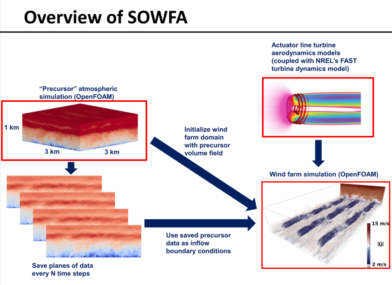

    Overview of the Simulator fOr Wind Farm Application(SOWFA)是美国能源实验室基于OpenFOAM平台开发的一些求解器。
    我的问题如下:
    1.Precursor atmospheric simulation得到的数据如速度等在边界面上如何提取?需要一系列时间的边界面数据。
    2.需要将1.提取的边界数据作为wind farm simulation的入口条件,网上查询到要使用TimeVaryingMappedFixedValue边界条件,该边界该如何使用?
    恳请大家赐教。

    这个边界条件我也没有用过。不过我刚才看了一下源代码。你看一下mapped和TimeVaryingMappedFixedValue的区别:
    //- Name of the field data table, defaults to the name of the field
            word fieldTableName_;
            //- If true adjust the mapped field to maintain average value
            Switch setAverage_;
            //- Fraction of perturbation (fraction of bounding box) to add
            scalar perturb_;
            //- Interpolation scheme to use
            word mapMethod_;
            //- 2D interpolation (for 'planarInterpolation' mapMethod)
            autoPtr<pointToPointPlanarInterpolation> mapperPtr_;
            //- List of boundaryData time directories
            instantList sampleTimes_;
            //- Current starting index in sampleTimes
            label startSampleTime_;
            //- Interpolated values from startSampleTime
            Field<Type> startSampledValues_;
            //- If setAverage: starting average value
            Type startAverage_;
            //- Current end index in sampleTimes
            label endSampleTime_;
            //- Interpolated values from endSampleTime
            Field<Type> endSampledValues_;
            //- If setAverage: end average value
            Type endAverage_;
            //- Time varying offset values to interpolated data
            autoPtr<Function1<Type>> offset_;
    Example of the boundary condition specification:
        \verbatim
        <patchName>
            type            mapped;
            fieldName       T;
            setAverage      no;
            average         0;
            interpolationScheme cell;
            value           uniform 0;
        \endverbatim
    TimeVaryingMappedFixedValue看起来就是附加了开始sample的时间以及结束sample时间的mapped边界条件。在时间之外,就是fixedValue。你核实下。
