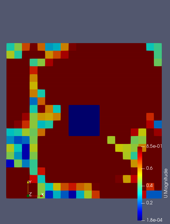

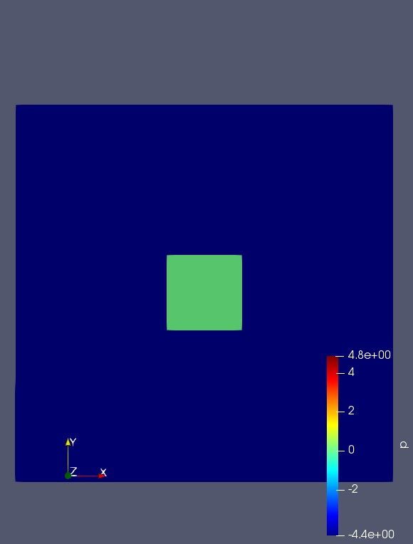

    modify the matrix, set the value of p and U as 0.

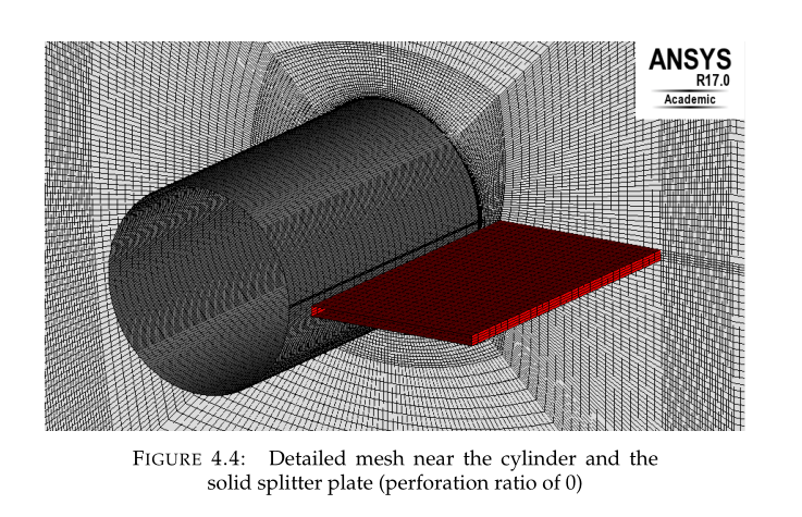

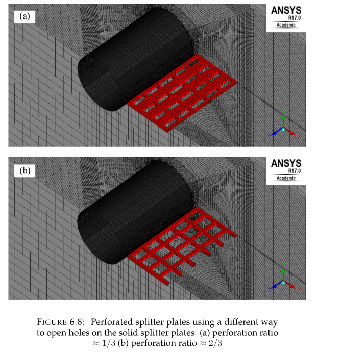

    (Sorry, I don't have chinese input right now)
    I once had the exactly same issue!
    Check my thesis Chapter 6.3 :
    https://scholar.uwindsor.ca/cgi/viewcontent.cgi?article=8585&context=etd
    I wrote a paper in this: https://ascelibrary.org/doi/pdf/10.1061/9780784415153.ch06
    Figure 2 is the original plate. (Sorry due to copy-right reason, I cannot put it here.)
    In my thesis, I had to open the plate with some holes in ICEM. So, I maual dig out the block out of the computation domain.
    It's really a painful process.
    But it works!
    This is the original plate:
    This is after the "dig":
    Yours in CFD,
    Ran
