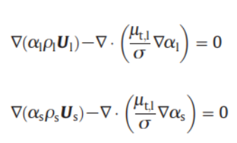

    This is the mass conservation equation I am using. The sign of laplacian term here is minus. However, as your page http://dyfluid.com/reactingTwoPhaseEulerFoam.html in equation(24), it should be plus I think if I understand well. I am confused that the sign of source term will induce large different result or no?
    The source term in Eq. (24) does not come from the laplacian term. It comes from the convection term. Eq. (24) is not related to your posted equations. The laplacian terms in your posted image are turbulent dispersion terms. In OpenFOAM they are not implemented in this manner.

    @东岳 If I understand well, equation (24) was changed by the sum of two mass conservation equation. However I must add that term in the mass conservation equation. So the position I implemented the laplacian term is right? The mass conservation equation shown in picture is our own equation.
    If you sum them up, $-\nabla\cdot(\nabla\alpha_l+\nabla\alpha_s)=0$ This term disappears.
