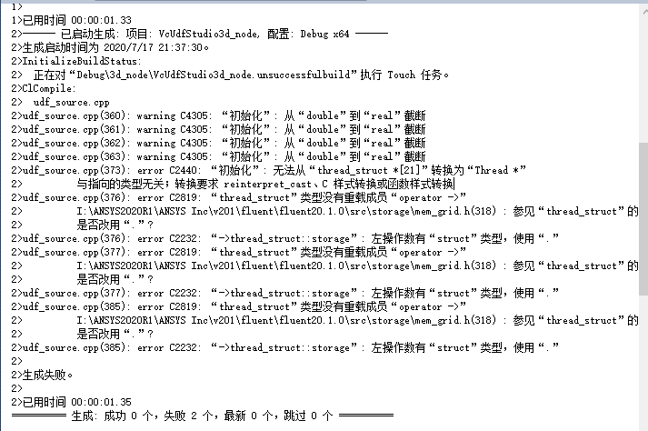

    Build的时候提示是这样的
    然后点击Load的提示是这样的
    编程功力不太行,只能按照示例在上面修改,很多地方不太懂,还请各位大佬帮忙看看,这究竟是咋回事呢?@东岳

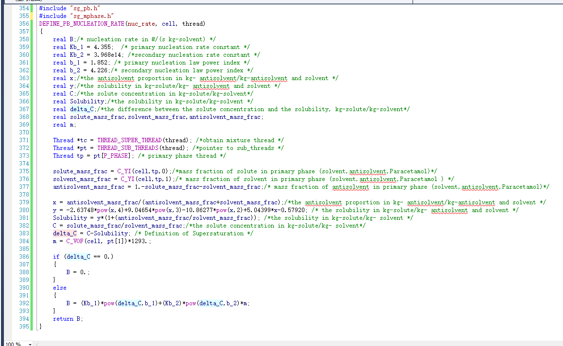

    你这注释的格式就有问题呀!
    #include "udf.h"
    #include "sg_pb.h"
    #include "sg_mphase.h"
    DEFINE_PB_NUCLEATION_RATE(nuc_rate, cell, thread)
    	real B;/* nucleation rate in #/(s kg-solvent) */
    	real Kb_1 = 4.355;  /* primary nucleation rate constant */
    	real Kb_2 = 3.968e14; /*secondary nucleation rate constant */
    	real b_1 = 1.852; /* primary nucleation law power index */
    	real b_2 = 4.226;/* secondary nucleation law power index */
    	real x;/*the antisolvent proportion in kg- antisolvent/kg-antisolvent and solvent */
    	real y;/*the solubility in kg-solute/kg- antisolvent and solvent */
    	real C;/*the solute concentration in kg-solute/kg-solvent*/
    	real Solubility;/*the solubility in kg-solute/kg-solvent */
    	real delta_C;/*the difference between the solute concentration and the solubility, kg-solute/kg-solvent*/
    	real solute_mass_frac,solvent_mass_frac,antisolvent_mass_frac;
    	real m;
    	Thread *tc = THREAD_SUPER_THREAD(thread); /*obtain mixture thread */
    	Thread *pt = THREAD_SUB_THREADS(thread); /*pointer to sub_threads */
    	Thread tp = pt[P_PHASE]; /* primary phase thread */
    	solute_mass_frac = C_YI(cell,tp,0);/*mass fraction of solute in primary phase (solvent,antisolvent,Paracetamol)*/
    	solvent_mass_frac = C_YI(cell,tp,1);/* mass fraction of solvent in primary phase (solvent,antisolvent,Paracetamol ) */
    	antisolvent_mass_frac = 1.-solute_mass_frac-solvent_mass_frac;/* mass fraction of antisolvent in primary phase (solvent,antisolvent,Paracetamol)*/
    	x = antisolvent_mass_frac/(antisolvent_mass_frac+solvent_mass_frac);/*the antisolvent proportion in kg- antisolvent/kg-antisolvent and solvent */
    	y = -2.63748*pow(x,4)+9.04654*pow(x,3)-10.86277*pow(x,2)+5.04399*x-0.57920; /* the solubility in kg-solute/kg- antisolvent and solvent */
    	Solubility = y*(1+(antisolvent_mass_frac/solvent_mass_frac)); /*the solubility in kg-solute/kg- solvent */
    	C = solute_mass_frac/solvent_mass_frac;/*the solute concentration in kg-solute/kg- solvent*/
    	delta_C = C-Solubility; /* Definition of Supersaturation */
    	m = C_VOF(cell, pt[1])*1293.;
    	if (delta_C == 0.)
    		B = 0.;
    	else
    		B = (Kb_1)*pow(delta_C,b_1)+(Kb_2)*pow(delta_C,b_2)*m;
    	return B;
    代码的部分问题我帮你修改了,不一定都正确,你自己再检查检查,然后再按上面这图中提示的信息自己查阅资料(无论UDF手册还是C语言基础书籍还是其他什么资料)去进行调试吧,加油!:146:

    @lee459317530 他注视格式不对是因为代码部分的"*"被当成正文里的markdown标记,被吃了:chigua2:
    @关伯兰在笑 开fluent的时候在“开始”里搜"commander",开那个带“x64”的,是commander tool还是啥。然后在那个终端里输入fluent,回车,这样的打开的fluent带64位编译功能。如果没有64位commander,需要安装visual studio。

    请问为什么要将Thread **pt = THREAD_SUB_THREADS(tc);改成Thread *pt = THREAD_SUB_THREADS(thread); 呢?
    我使用Thread **pt = THREAD_SUB_THREADS(tc);的时候就显示“生成成功”了
    但还是有之前同样的问题

    @关伯兰在笑 楼主的代码是没问题的,我在自己电脑编译通过了。应该是编译环境的问题,试试重装个编译器吧,我一直用VS2010,比较稳定
