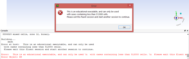

    如果跑60万网格会提示什么?

    Ansys19.1 student,网格超过51.2万时的报错信息:
    Error at host: This is an educational executable, and can only be used
    with cases containing less than 512000 cells.
    Please exit this fluent session and start another session to continue.
    Error: This is an educational executable, and can only be used \n with cases containing less than 512000 cells. \n Please exit this fluent session and start another session to continue.
    Error Object: #f
