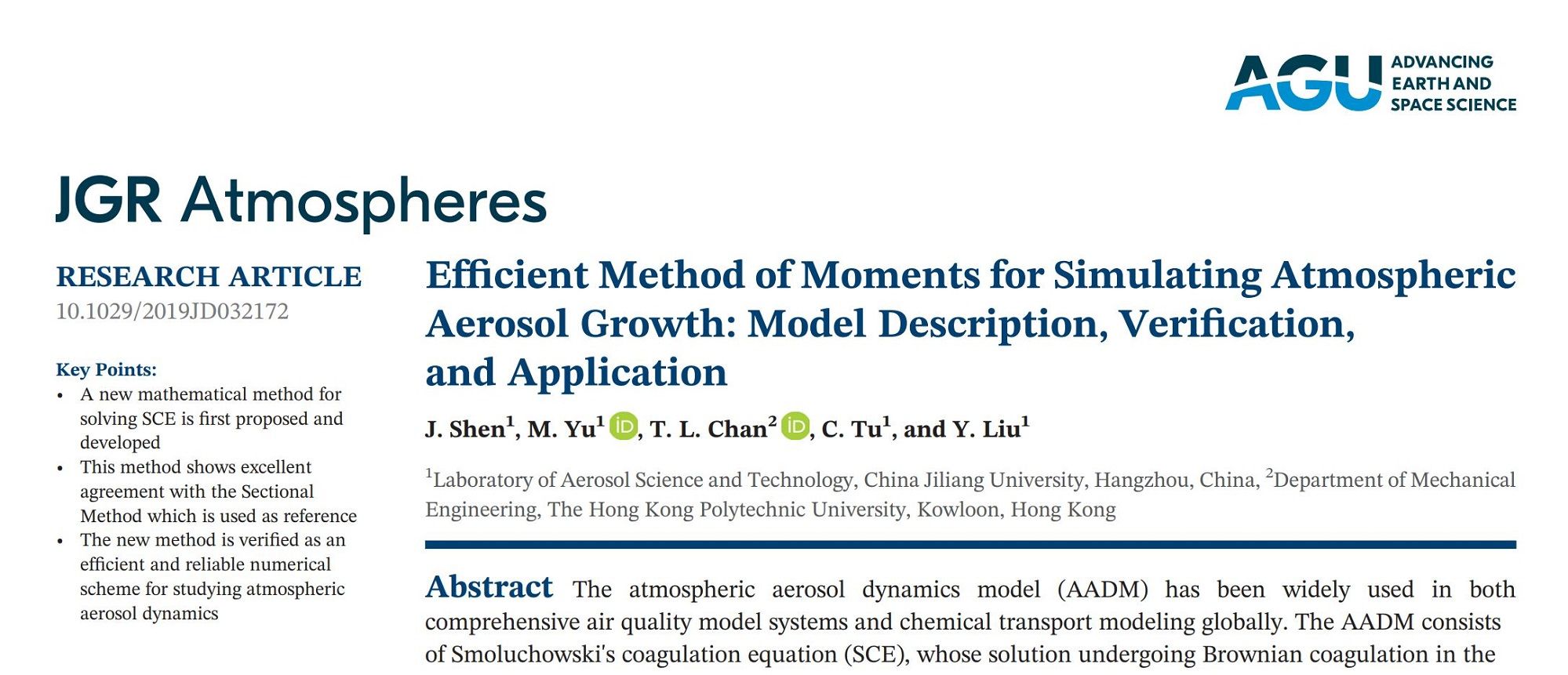

    Efficient Method of Moments for Simulating Atmospheric Aerosol Growth: Model Description, Verification, and Application
    TEMOM系列新文章。目前里面跟踪的矩为$m_0,m_1,m_2$,不知道$m_3$等高阶矩好跟踪不 @bestucan
