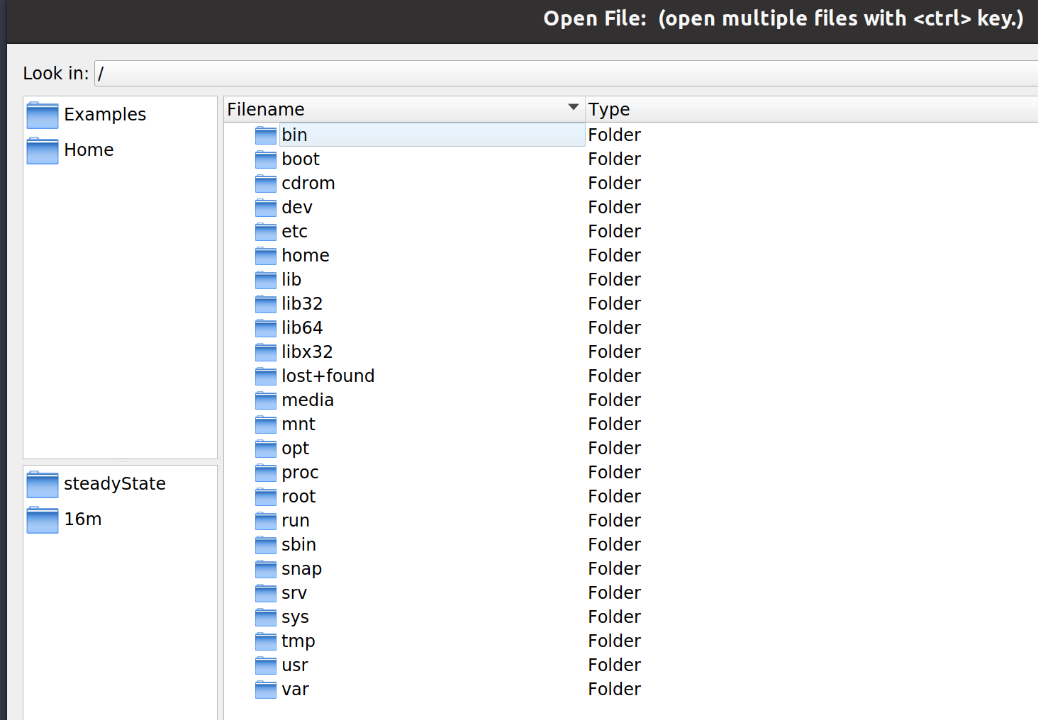

    Sorry my Chinese input is missing. Actually you can open your hard drive in /media folder, as you can see in the following image. Its still not necessary to compile it.
