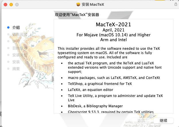

    1. 下载MacTex,完整安装包4GB左右
      https://www.tug.org/mactex/

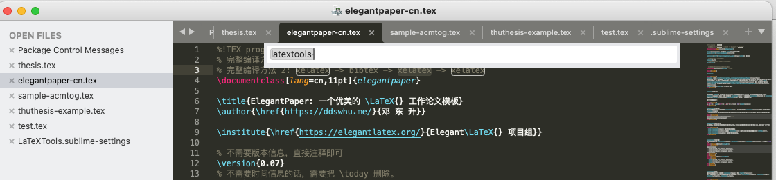

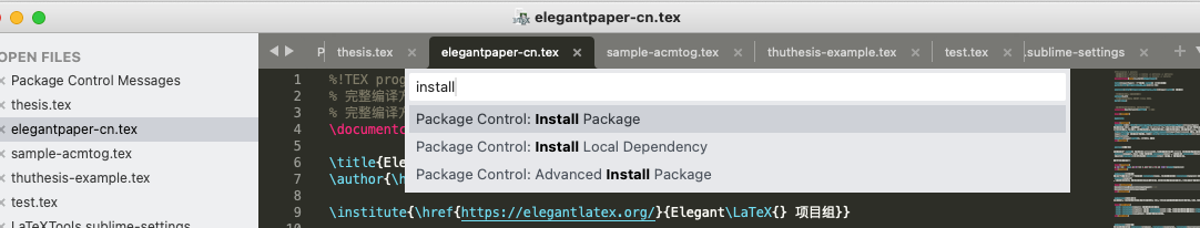

    2.2 在Sublime Text里Command+Shift+P调出命令窗口,输入Install,之后选择LaTexTools, 我的因为已经安装过了,所以没有下面的选项,

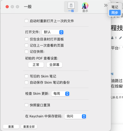

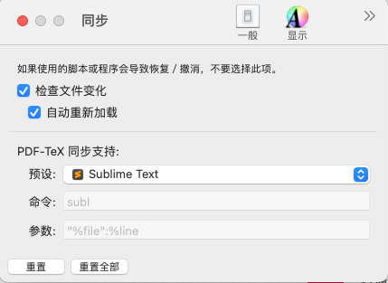

    3.下载skim, PDF阅读器,可以实时编译,有点类似overleaf在线一样的效果,设置同步,如下图。
    https://skim-app.sourceforge.io/
    至此,英文环境就没问题了。

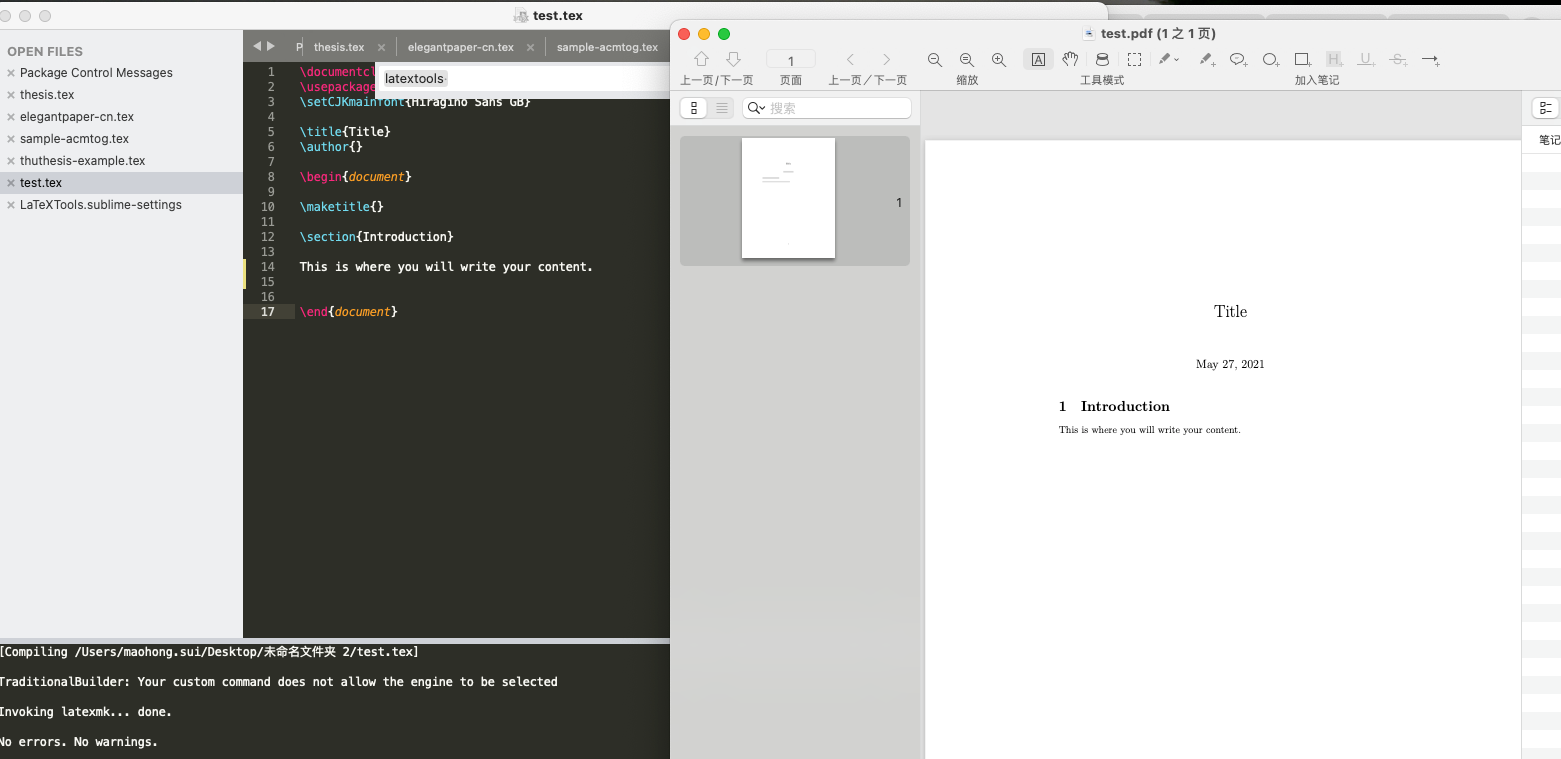

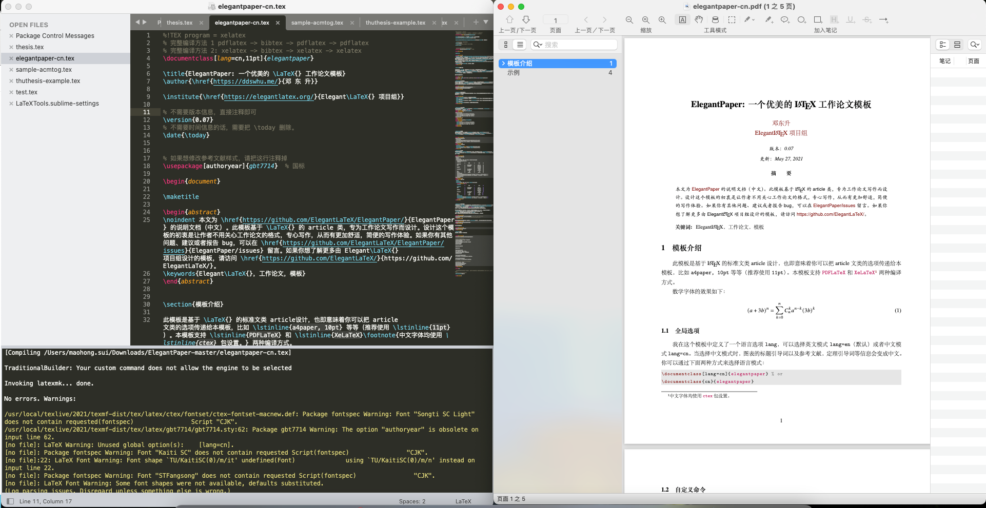

    在sublime中 工具- 编译系统-选择LaTeX
    然后 command+B即可编译
    效果如下

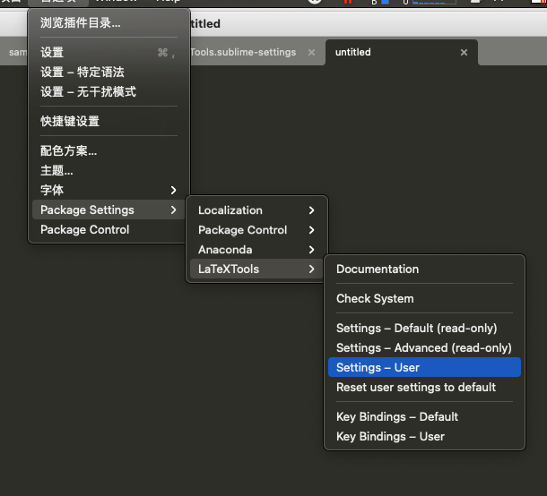

    然后在Sublime中,Preferences——Package Settings——LaTeXTools——Reconfigure LaTeXTools and migrate settings重建配置文件),在builder-settings下面新增两项配置:
    "program" : "xelatex",
    "command" : ["latexmk", "-cd", "-e", "$pdflatex = 'xelatex -interaction=nonstopmode -synctex=1 %S %O'", "-f", "-pdf"],

    1. 测试
      随便选了一个中文模板,中间会要求下载字体。
      https://www.latexstudio.net/archives/51626.html
    清华的LaTeX模版编译总会提示Error,错误Log如下
    [Compiling /Users/xxxxxxxx/Downloads/thuthesis-master/thuthesis-example.tex]
    TraditionalBuilder: Your custom command does not allow the engine to be selected
    Invoking latexmk... done.
    Errors:
    /usr/local/texlive/2021/texmf-dist/tex/latex/thuthesis/thuthesis.cls:1019: Package fontspec Error: The font "Kaiti SC Regular" cannot be found. [\thu@set@cjk@font]
    /usr/local/texlive/2021/texmf-dist/tex/latex/thuthesis/thuthesis.cls:1019: Cannot use \XeTeXfeaturename with nullfont; not an AAT or Graphite font. [\thu@set@cjk@font]
    /usr/local/texlive/2021/texmf-dist/tex/latex/thuthesis/thuthesis.cls:1019: Cannot use \XeTeXisexclusivefeature with nullfont; not an AAT or Graphite font. [\thu@set@cjk@font]
    /usr/local/texlive/2021/texmf-dist/tex/latex/thuthesis/thuthesis.cls:1019: Cannot use \XeTeXselectorname with nullfont; not an AAT or Graphite font. [\thu@set@cjk@font]
    /usr/local/texlive/2021/texmf-dist/tex/latex/thuthesis/thuthesis.cls:1019: Missing \endcsname inserted. [\thu@set@cjk@font]
    /usr/local/texlive/2021/texmf-dist/tex/latex/thuthesis/thuthesis.cls:1019: LaTeX Error: Missing \begin{document}. [\thu@set@cjk@font]
    /usr/local/texlive/2021/texmf-dist/tex/latex/thuthesis/thuthesis.cls:1019: Extra \endcsname. [\thu@set@cjk@font]
    /usr/local/texlive/2021/texmf-dist/tex/latex/thuthesis/thuthesis.cls:1019: Package fontspec Error: The font "Kaiti SC Bold" cannot be found. [\thu@set@cjk@font]
    Warnings:
    /Users/xxxxxx/Downloads/thuthesis-master/data/appendix.tex: LaTeX Warning: `h' float specifier changed to `ht'.
    /Users/xxxxxxx/Downloads/thuthesis-master/thuthesis-example.log:1: Double-click here to open the full log.
    [Done!]

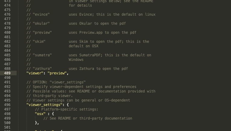

    1. 如果不想使用Skim的话,可以在LatexTools中做如下设置
      在Settings中的第487行,将"viewer": "",改为"viewer": "preview",这个操作会让你在Sublime Text3中build完.tex后自动弹出预览(preview),以便检查PDF文件。

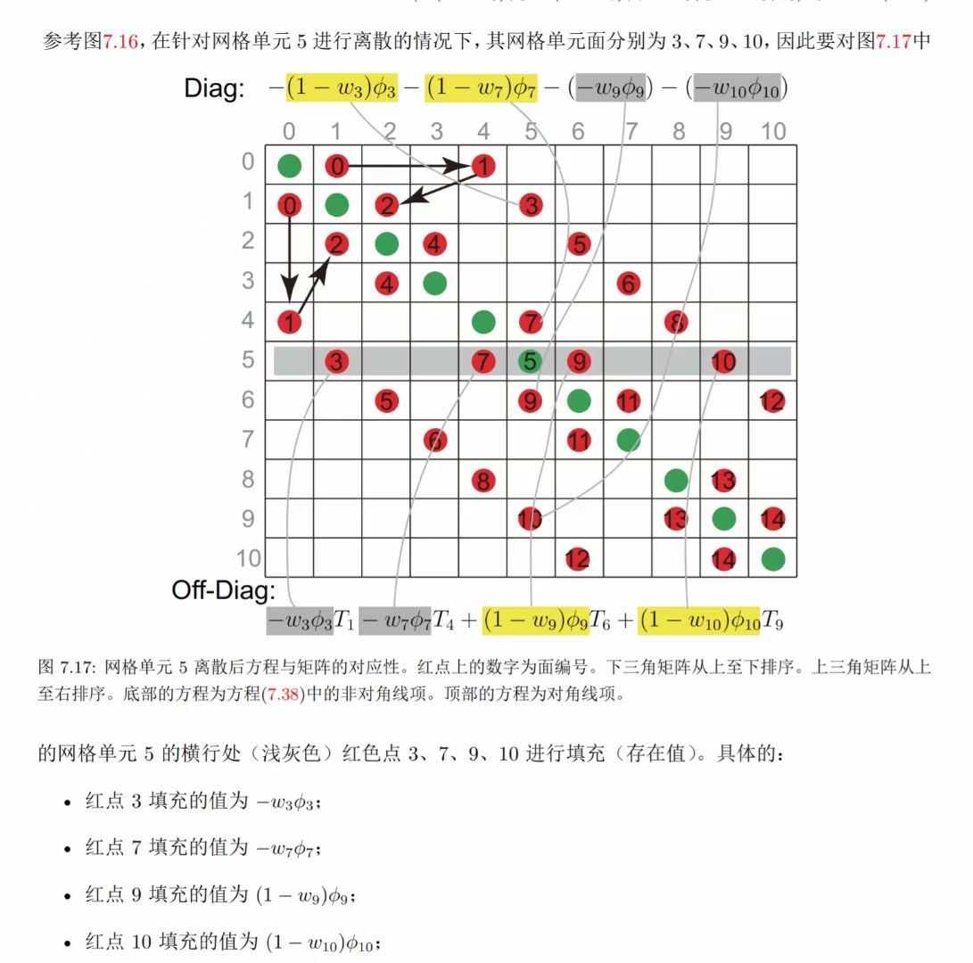

    @李东岳 请教东岳大佬,我看见你在朋友圈发了几张图挺漂亮的,能公开一下开代码吗?
    在 中回复了 chengan.wang 最后由 编辑
    @chengan-wang http://www.dyfluid.cn/theory.pdf
    chengan.wangC 1 条回复 最后回复
  • chengan.wangC 离线
    chengan.wangC 离线
    chengan.wang
    @李东岳 这些图有对应的latex源代码么?
    @chengan-wang 没有,这是用Adobe AI做的
