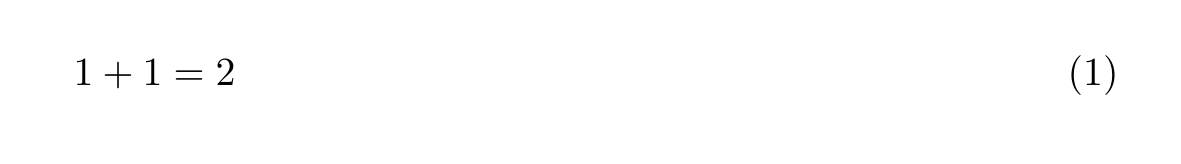

    可以用newcommand
    \newcommand\xx{\begin{equation}}
    \newcommand\xxx{\end{equation}}
    \xx
    1+1=2
    \xxx
    输出:
