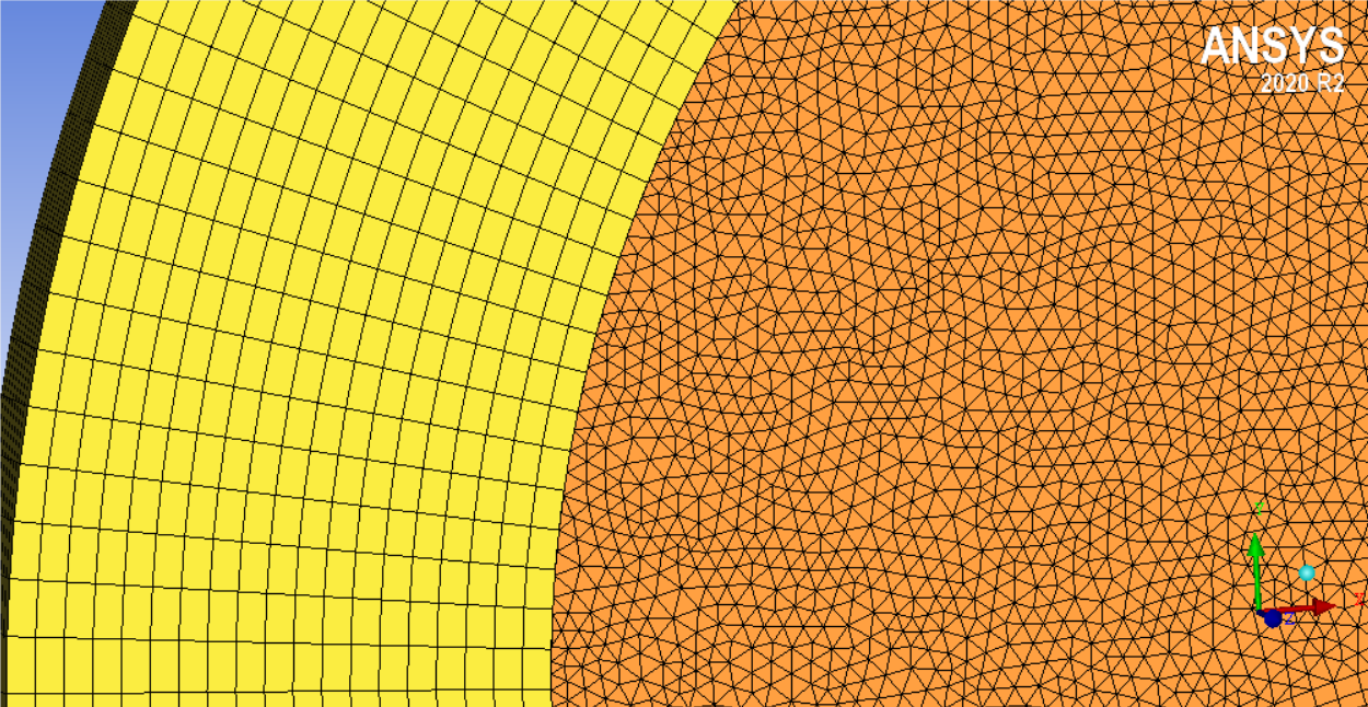

    黄色定义为outwall ,其交界面定义为interface_AA,
    程色定义为innerwall,其交接面定义为interface_A,
    但是在导入openFOAM后产生一个警告
    --> FOAM Warning : fluent mesh has 7716 undefined boundary faces.
    Adding undefined faces to new patch default_wall
    default_wall就是interface_AA与interface_A加在了一起。
    有没有人遇到过这个问题,希望能指导一下我。

    @yingqing 你现在这个交界面是1个面还是2个面,在openfoam里面

    @李东岳 老师,我已经找到了问题所在,在网格转换的时候应该使用fluent3DMeshtoFoam而不是fluentMeshtoFoam。
    改换命令后已经已经可以生成patch,但是产生了新的错误,还在重新搞:141:
    patch 0 from Fluent indices: 1244523 to: 1277792 type: wall
    patch 1 from Fluent indices: 1277793 to: 1280230 type: interface
    patch 2 from Fluent indices: 1280231 to: 1283685 type: wall
    patch 3 from Fluent indices: 1283686 to: 1288913 type: interface
    patch 4 from Fluent indices: 1288914 to: 1330832 type: wall
    --> FOAM FATAL ERROR:
    Illegal cell label -1 in neighbour addressing for face 1295125
    yingqing
    已经获得成功。
    icem中创建的part对应着openFOAM中的boundarys
    icem中创建的body对应着openfoam中的cellzones
