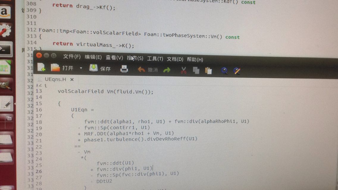

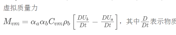

    ![2_1480649015125_TLK}(R4}B0D9XTKMSRXM}3.png 1_1480649015125_B2F9ECC6F0BDE926FB39BD6FEDD898C2.png 0_1480649015124_2D5B18464608774C68E84206AB2B7734.png
    我觉得两相欧拉求解器这里面少一项alpha2,大家觉得能,或者我漏掉什么细节了?大家看看吧,谢谢

    Could you please check the other terms? e.g., lift force
