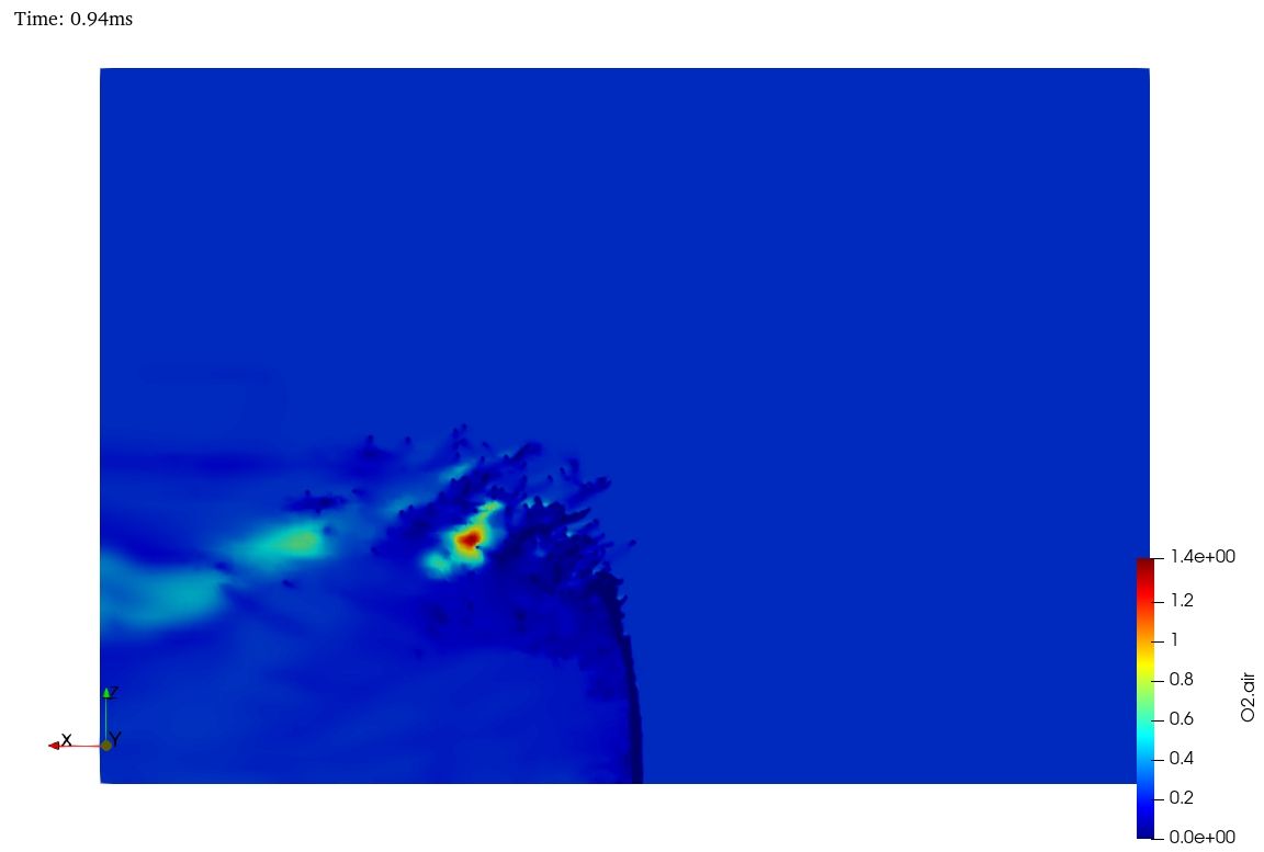

    各位老师,晚上好
    我参考了$InterAdsFoam: An Open-Source CFD Model for Granular Media–Adsorption Systems with Dynamic Reaction Zones Subject to Uncontrolled Urban Water Fluxes$和$phaseScalarTransport.C$在compressibleInterFoam中添加了组分方程,个人感觉这个组分方程形式也不是非常复杂,但是在求解过程中会出现局部质量分数增加的情况,如下图所示,想请教一下大家有没有什么建议?
    volScalarField Deff("Deff",turbulence.muEff());
    volScalarField alpharho
        "alpharho",
        alpha2*rho2
    surfaceScalarField alphaPhi
        "alphaPhi",
        linearInterpolate(alpha2*rho2*U) & mesh.Sf()
                fvScalarMatrix alpha2YEqn
                    fvm::ddt(alpharho, Yi)
                  + fvm::div(alphaPhi, Yi)
                  - fvm::laplacian
                    fvc::interpolate(Deff)*fvc::interpolate(alpha2),
                    Yi
                     fvOptions(alpha2, rho2, Yi)
                  - fvm::ddt(residualAlpha_*rho2, Yi)
                  + fvc::ddt(residualAlpha_*rho2,Yi)
                alpha2YEqn.relax();
                fvOptions.constrain(alpha2YEqn);
                alpha2YEqn.solve(mesh.solver("Yi"));
                fvOptions.correct(Yi);
                Yi.max(0.0);
                //update the results
                Yi = Yi*alpha2; // should use this guys as Yi
                Yt += Yi;

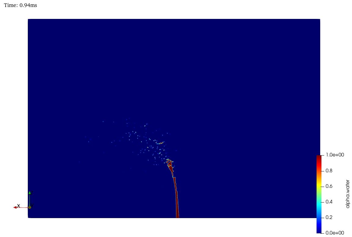

    O2:
    alpha:

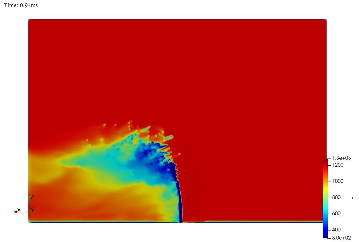

    T:
