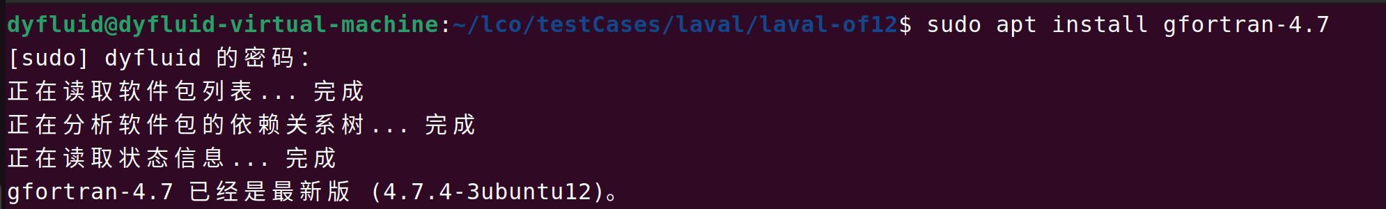

    你得问题,主要是gfortran没装上,我试了一下,我这面能装上,也是2204,
    下面是我的源
    deb http://archive.ubuntu.com/ubuntu/ jammy main restricted universe multiverse
    # deb-src http://archive.ubuntu.com/ubuntu/ jammy main restricted universe multiverse
    deb http://archive.ubuntu.com/ubuntu/ jammy-updates main restricted universe multiverse
    # deb-src http://archive.ubuntu.com/ubuntu/ jammy-updates main restricted universe multiverse
    deb http://archive.ubuntu.com/ubuntu/ jammy-security main restricted universe multiverse
    # deb-src http://archive.ubuntu.com/ubuntu/ jammy-security main restricted universe multiverse
    deb http://archive.ubuntu.com/ubuntu/ jammy-backports main restricted universe multiverse
    # deb-src http://archive.ubuntu.com/ubuntu/ jammy-backports main restricted universe multiverse
    deb http://archive.canonical.com/ubuntu/ jammy partner
    # deb-src http://archive.canonical.com/ubuntu/ jammy partner
    deb http://cn.archive.ubuntu.com/ubuntu/ xenial main
    deb http://cn.archive.ubuntu.com/ubuntu/ xenial universe
    deb http://mirrors.aliyun.com/ubuntu/ trusty main
    deb-src http://mirrors.aliyun.com/ubuntu/ trusty universe
    在这个链接里面,写了如何安装老版本的fortran: https://www.cfd-china.com/topic/4196/ubuntu-20-04-安装-openfoam-v1712
    另外我看你也是用的虚拟机。你还不如直接下载一个我装好的,你这卡了好几条了。现在个我那个15分钟就完事了。
