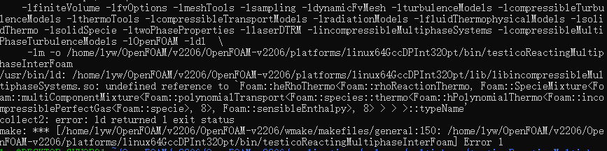

    我想在icoReactingMultiphaseInterFoam求解器中加一个新的物性库组合,polynomialTransport hPolynomialThermo incompressiblePerfectGas<specie>,sensibleEnthalpy。物性组合的文件在\v2206\OpenFOAM-v2206\src\phaseSystemModels\multiphaseInter\phasesSystem\InterfaceCompositionModel\InterfaceCompositionModels.C,在文件中定义了我要的物性组合
           typedef
    polynomialTransport
        species::thermo
            hPolynomialThermo
                8
            sensibleEnthalpy
        8
    > mymyicoPoly8HThermoPhysics;
    加到了组合中
        makeInterfaceContSpecieMixtureType
            Lee,
            heRhoThermo,
            rhoThermo,
            pureMixture,
            constRhoHThermoPhysics,
            heRhoThermo,
            rhoReactionThermo,
            multiComponentMixture,
    库文件编译通过,
    -lfiniteVolume -lfvOptions -lmeshTools -lsampling -ldynamicFvMesh -lturbulenceModels -lcompressibleTurbulenceModels -lthermoTools -lcompressibleTransportModels -lradiationModels -lfluidThermophysicalModels -lsolidThermo -lsolidSpecie -ltwoPhaseProperties -llaserDTRM -lincompressibleMultiphaseSystems -lcompressibleMultiPhaseTurbulenceModels -lOpenFOAM -ldl
    -lm -o /home/lyw/OpenFOAM/v2206/OpenFOAM-v2206/platforms/linux64GccDPInt32Opt/bin/testicoReactingMultiphaseInterFoam
    /usr/bin/ld: /home/lyw/OpenFOAM/v2206/OpenFOAM-v2206/platforms/linux64GccDPInt32Opt/lib/libincompressibleMultiphaseSystems.so: undefined reference to `Foam::heRhoThermo<Foam::rhoReactionThermo, Foam::SpecieMixture<Foam::multiComponentMixture<Foam::polynomialTransport<Foam::species::thermo<Foam::hPolynomialThermo<Foam::incompressiblePerfectGasFoam::specie, 8>, Foam::sensibleEnthalpy>, 8> > > >::typeName'
    collect2: error: ld returned 1 exit status
    make: *** [/home/lyw/OpenFOAM/v2206/OpenFOAM-v2206/wmake/makefiles/general:150: /home/lyw/OpenFOAM/v2206/OpenFOAM-v2206/platforms/linux64GccDPInt32Opt/bin/testicoReactingMultiphaseInterFoam] Error 1
    另外这个就可以不报错,
            Lee,
            heRhoThermo,
            rhoThermo,
            pureMixture,
            heRhoThermo,
            rhoReactionThermo,
    其中icoPoly8HThermoPhysics如下
    typedef
    polynomialTransport
    species::thermo
    hPolynomialThermo
    icoPolynomial<specie, 8>,
    8
    sensibleEnthalpy
    8
    请问,怎么才能将报错的组合编译成功?是哪里错了吗?没提到的地方基本都没有改动
