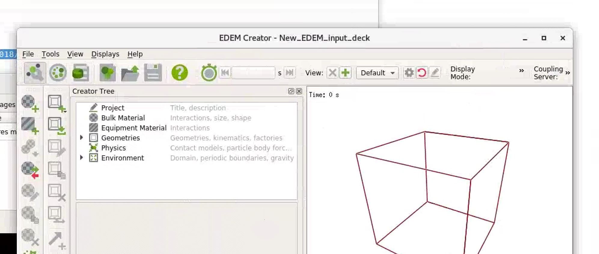

    客户提供的安装包,给研究装了一下,挺麻烦的还。简单记录一下
    wget -O CentOS-Base.repo http://mirrors.aliyun.com/repo/Centos-7.repo
    yum clean all
    yum makecache
    yum install libgcc.i686 libstdc++.i686 glibc.i686
    yum install qt5-qtbase qt5-qtbase-devel libxcb libxcb-devel xcb-util xcb-util-image xcb-util-keysyms xcb-util-renderutil xcb-util-wm
    rpm2cpio EDEM.rpm | cpio -div
    rpm2cpio EDEMlic.rpm | cpio -div
    cp -r opt/DEMSolutions/ /opt/
    cp -r opt/SentinelLM/ /opt/
    cp EDEM_SSQ.lic /opt/SentinelLM/bin/
    cp -f /opt/DEMSolutions/EDEM_2018/lib/lib* /usr/lib64/

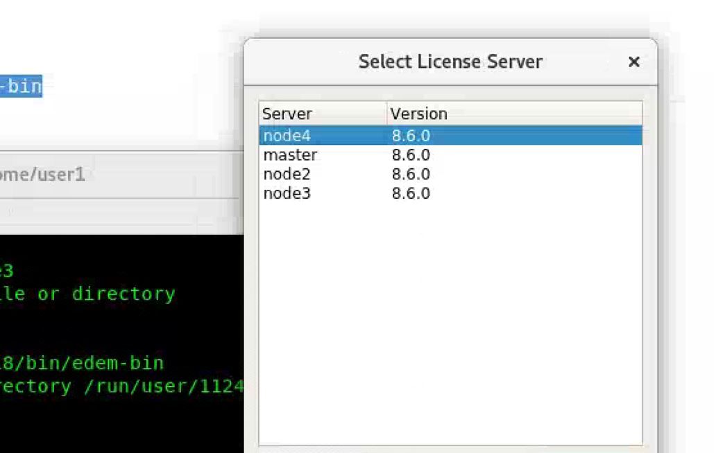

    /opt/SentinelLM/bin/lserv
    /opt/SentinelLM/bin/lslic -f /opt/SentinelLM/bin/EDEM_SSQ.lic
    /opt/DEMSolutions/EDEM_2018/bin/edem-bin
    http://dyfluid.com/index.html
    如果提示xcb的问题,注意一下libudev.so.0这个库能不能找到
