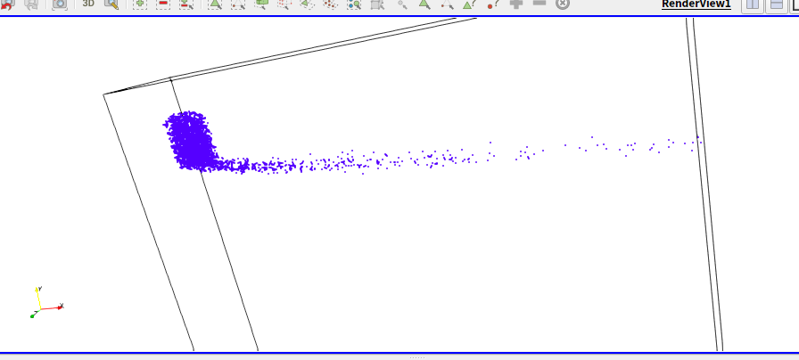

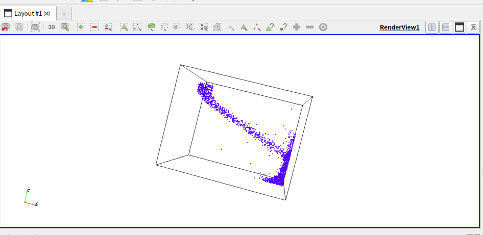

    在用fix wall/gran设置墙壁的时候没有效果,粒子还是会从边界穿出去,对照另一个算例写的命令整体差不多,但是那个算例就能挡住粒子,不知道为什么
    这是我仿真图,粒子会从边界右边出来
    这是那个算例,颗粒可以堆积
    下面是我的命令,有大佬可以帮我看看问题一在哪吗,不胜感激!!
    atom_style      granular
    atom_modify     map array
    boundary        f f f
    newton          off
    communicate     single vel yes
    units           si
    region          domain block -3 3 0 4 0 1 units box
    create_box      1 domain
    neighbor        0.004 bin
    neigh_modify    delay 0
    pair_style  gran model hertz tangential history
    pair_coeff  * *
    timestep    0.00001
    fix integr all nve/sphere
    fix gravity all gravity 9.81 vector 0.0 -1.0 0.0
    fix m1 all property/global youngsModulus peratomtype 1e6
    fix m2 all property/global poissonsRatio peratomtype 0.42
    fix m3 all property/global coefficientRestitution peratomtypepair 1 0.9
    fix m4 all property/global coefficientFriction peratomtypepair 1 0.1
    fix m5 all property/global coefficientRollingFriction peratomtypepair 1 0.5
    fix	wallxmin all wall/gran model hertz tangential history primitive type 1 xplane -2.95
    fix	wallxmax all wall/gran model hertz tangential history primitive type 1 xplane 2.95
    fix	wallymin all wall/gran model hertz tangential history primitive type 1 yplane 0.0
    fix	wallymax all wall/gran model hertz tangential history primitive type 1 yplane 3.8
    fix	wallzmin all wall/gran model hertz tangential history primitive type 1 zplane 0.0
    fix pts1 all particletemplate/sphere 123575 atom_type 1 density constant 1000 radius constant 0.002
    fix pdd1 all particledistribution/discrete 123457 1 pts1 1.0
    region	spray block -2.8 -2.0 2.0 3.0 0.2 0.8 units box
    fix	push all addforce 0.01 0.0 0.0 region spray
    region	fire block -2.7 -2.2 3.0 3.6 0.4 0.6 units box
    fix  ins1 all insert/rate/region seed 5330 distributiontemplate pdd1 nparticles 10000 particlerate 10000 vel constant 0.0 0.0 -1.0 &
        insert_every 500 overlapcheck yes region fire ntry_mc 10000
    thermo          1000
    thermo_modify   lost ignore norm no
    compute_modify  thermo_temp dynamic yes
    run 1
    dump dmp all custom 200 post/liggghts_init_*.liggghts id type x y z vx vy vz fx fy fz omegax omegay omegaz radius
    run 100000 upto

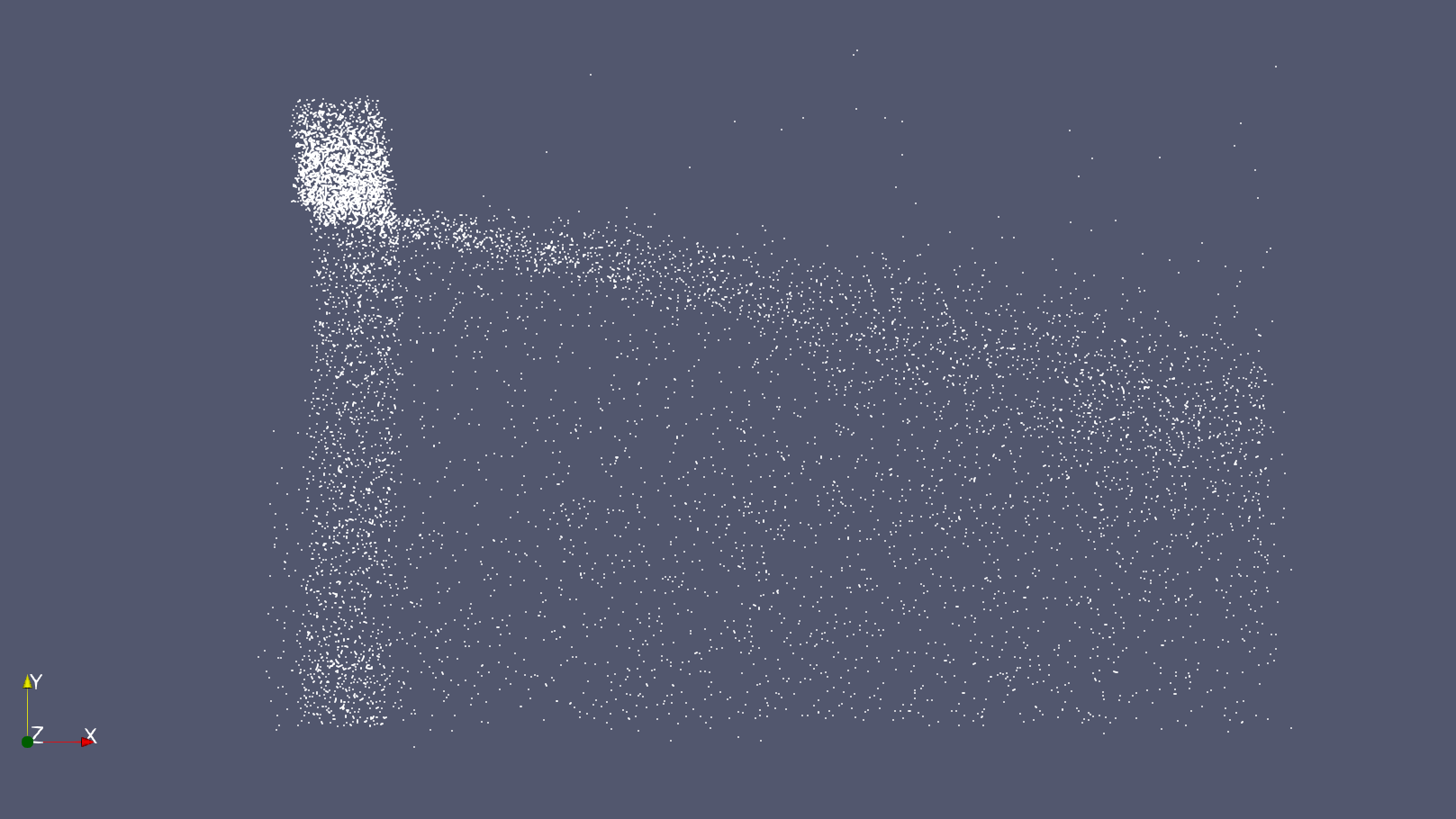

    我给你跑了一下,除了z方向墙设置太大会漏粒子,其他没问题呀,x方向的墙可以正常碰撞呀

    在 中回复了 chapaofan 最后由 编辑
    @chapaofa 大佬辛苦啦,我跑就是这样,不知道为啥,感觉命令没问题,我换台电脑试试吧。谢谢啦!
