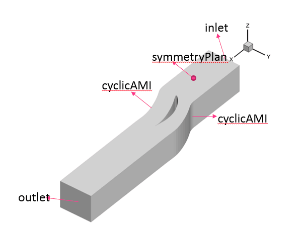

    我需要给定进口总温总压,进口气流速度角度,以及出口静压请问,这么给是否有问题,总是挂。1_1490324845490_U 0_1490324845490_p
    你要很小心设置压力进出口边界条件,从理论来讲这并不是最稳定的边界条件,当然是可以算的并且可以算正确。你用的哪个求解器?网格类型是什么?网格质量如何?把边界条件贴一下?

    @cfd-china 您好,我算的马赫数大约0.6,是一个平面的压气机叶栅,目前用的是simpleFoam,网格用pointwise画的,检查质量ok,但总是挂掉,K,Omega总是超级大。0_1490340380917_1FBQNZ_3CW{X(HG@529NXYB.png

    smoothSolver:  Solving for k, Initial residual = 0.0256925, Final residual = 0.00171392, No Iterations 4
    ExecutionTime = 193.33 s  ClockTime = 196 s
    Time = 15
    smoothSolver:  Solving for Ux, Initial residual = 0.173376, Final residual = 0.0142151, No Iterations 6
    smoothSolver:  Solving for Uy, Initial residual = 0.141625, Final residual = 0.0112524, No Iterations 7
    smoothSolver:  Solving for Uz, Initial residual = 0.203415, Final residual = 0.0168199, No Iterations 6
    GAMG:  Solving for p, Initial residual = 0.850352, Final residual = 0.0820699, No Iterations 8
    time step continuity errors : sum local = 1261.82, global = 852.091, cumulative = 2670.96
    smoothSolver:  Solving for omega, Initial residual = 0.000119946, Final residual = 3.04546e-06, No Iterations 2
    smoothSolver:  Solving for k, Initial residual = 0.0523867, Final residual = 0.00451596, No Iterations 2
    ExecutionTime = 206.27 s  ClockTime = 209 s
    Time = 16
    smoothSolver:  Solving for Ux, Initial residual = 0.189402, Final residual = 0.0147132, No Iterations 6
    smoothSolver:  Solving for Uy, Initial residual = 0.172538, Final residual = 0.0148313, No Iterations 6
    smoothSolver:  Solving for Uz, Initial residual = 0.216101, Final residual = 0.0175322, No Iterations 6
    GAMG:  Solving for p, Initial residual = 0.831111, Final residual = 0.0800892, No Iterations 13
    time step continuity errors : sum local = 1124.03, global = -888.775, cumulative = 1782.18
    smoothSolver:  Solving for omega, Initial residual = 0.000132821, Final residual = 2.71341e-06, No Iterations 2
    smoothSolver:  Solving for k, Initial residual = 0.0429148, Final residual = 0.00279213, No Iterations 3
    ExecutionTime = 220.4 s  ClockTime = 223 s
    Time = 17
    smoothSolver:  Solving for Ux, Initial residual = 0.240906, Final residual = 0.0185245, No Iterations 6
    smoothSolver:  Solving for Uy, Initial residual = 0.481738, Final residual = 0.0406032, No Iterations 5
    smoothSolver:  Solving for Uz, Initial residual = 0.306464, Final residual = 0.0227411, No Iterations 6
    GAMG:  Solving for p, Initial residual = 0.829137, Final residual = 0.0797512, No Iterations 5
    time step continuity errors : sum local = 1176.95, global = 495.085, cumulative = 2277.27
    smoothSolver:  Solving for omega, Initial residual = 0.000148683, Final residual = 1.27859e-05, No Iterations 1
    smoothSolver:  Solving for k, Initial residual = 0.0542324, Final residual = 0.0033722, No Iterations 3
    ExecutionTime = 231.68 s  ClockTime = 235 s
    Time = 18
    smoothSolver:  Solving for Ux, Initial residual = 0.206106, Final residual = 0.0161844, No Iterations 6
    smoothSolver:  Solving for Uy, Initial residual = 0.255402, Final residual = 0.0223374, No Iterations 5
    smoothSolver:  Solving for Uz, Initial residual = 0.341787, Final residual = 0.0275786, No Iterations 6
    GAMG:  Solving for p, Initial residual = 0.827099, Final residual = 0.082525, No Iterations 7
    time step continuity errors : sum local = 1134.39, global = 819.278, cumulative = 3096.54
    smoothSolver:  Solving for omega, Initial residual = 9.46476e-05, Final residual = 2.25188e-06, No Iterations 2
    smoothSolver:  Solving for k, Initial residual = 0.0505738, Final residual = 0.00348548, No Iterations 3
    ExecutionTime = 242.31 s  ClockTime = 246 s
    Time = 19
    smoothSolver:  Solving for Ux, Initial residual = 0.199931, Final residual = 0.0167285, No Iterations 6
    smoothSolver:  Solving for Uy, Initial residual = 0.361021, Final residual = 0.0275666, No Iterations 6
    smoothSolver:  Solving for Uz, Initial residual = 0.234612, Final residual = 0.0186392, No Iterations 6
    GAMG:  Solving for p, Initial residual = 0.829252, Final residual = 0.0781392, No Iterations 18
    time step continuity errors : sum local = 1182.87, global = 1048.32, cumulative = 4144.86
    smoothSolver:  Solving for omega, Initial residual = 0.000103443, Final residual = 9.28303e-06, No Iterations 1
    smoothSolver:  Solving for k, Initial residual = 0.160832, Final residual = 0.0122526, No Iterations 1
    ExecutionTime = 255.21 s  ClockTime = 259 s
    Time = 20
    smoothSolver:  Solving for Ux, Initial residual = 0.203207, Final residual = 0.0177404, No Iterations 6
    smoothSolver:  Solving for Uy, Initial residual = 0.328249, Final residual = 0.0269088, No Iterations 6
    smoothSolver:  Solving for Uz, Initial residual = 0.224519, Final residual = 0.0164899, No Iterations 6
    GAMG:  Solving for p, Initial residual = 0.838448, Final residual = 0.0774968, No Iterations 16
    time step continuity errors : sum local = 1282.19, global = 1084.48, cumulative = 5229.34
    smoothSolver:  Solving for omega, Initial residual = 0.000137159, Final residual = 1.18779e-05, No Iterations 1
    smoothSolver:  Solving for k, Initial residual = 0.105212, Final residual = 0.00733032, No Iterations 2
    ExecutionTime = 268.59 s  ClockTime = 273 s
    Time = 21
    smoothSolver:  Solving for Ux, Initial residual = 0.195891, Final residual = 0.0166656, No Iterations 6
    smoothSolver:  Solving for Uy, Initial residual = 0.295498, Final residual = 0.0264212, No Iterations 6
    smoothSolver:  Solving for Uz, Initial residual = 0.256556, Final residual = 0.019235, No Iterations 6
    GAMG:  Solving for p, Initial residual = 0.820159, Final residual = 0.0809549, No Iterations 27
    time step continuity errors : sum local = 1210.13, global = -1110.62, cumulative = 4118.72
    smoothSolver:  Solving for omega, Initial residual = 0.000209472, Final residual = 1.33081e-05, No Iterations 1
    smoothSolver:  Solving for k, Initial residual = 0.0963909, Final residual = 0.00779254, No Iterations 2
    ExecutionTime = 283.95 s  ClockTime = 288 s
    Time = 22
    smoothSolver:  Solving for Ux, Initial residual = 0.210533, Final residual = 0.0180219, No Iterations 5
    smoothSolver:  Solving for Uy, Initial residual = 0.451871, Final residual = 0.0368704, No Iterations 6
    smoothSolver:  Solving for Uz, Initial residual = 0.267514, Final residual = 0.0242343, No Iterations 5
    GAMG:  Solving for p, Initial residual = 0.828406, Final residual = 0.0758993, No Iterations 30
    time step continuity errors : sum local = 1183.8, global = 1080.35, cumulative = 5199.06
    smoothSolver:  Solving for omega, Initial residual = 0.00040392, Final residual = 1.58342e-05, No Iterations 1
    smoothSolver:  Solving for k, Initial residual = 0.116199, Final residual = 0.00839545, No Iterations 2
    ExecutionTime = 299.9 s  ClockTime = 304 s
    Time = 23
    smoothSolver:  Solving for Ux, Initial residual = 0.223249, Final residual = 0.0207695, No Iterations 5
    smoothSolver:  Solving for Uy, Initial residual = 0.479522, Final residual = 0.0438371, No Iterations 5
    smoothSolver:  Solving for Uz, Initial residual = 0.287509, Final residual = 0.0233311, No Iterations 5
    GAMG:  Solving for p, Initial residual = 0.819938, Final residual = 0.0816971, No Iterations 21
    time step continuity errors : sum local = 1364, global = -1206.8, cumulative = 3992.26
    smoothSolver:  Solving for omega, Initial residual = 0.000308337, Final residual = 2.31198e-05, No Iterations 1
    smoothSolver:  Solving for k, Initial residual = 0.183739, Final residual = 0.0103415, No Iterations 2
    ExecutionTime = 314.31 s  ClockTime = 319 s
    质量严重不守恒,为何不把网格做到10万以下,轻量级跑跑试试?
