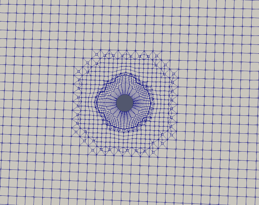

    我使用多相流求解器求解浓度场时,发现在障碍物附近对网格进行加密后,会出现这样的异常,我是用的snappyHexMesh绘制的网格,请问有没有老师之前遇到过类似的问题。是网格的问题还是求解器中的设置问题?

    感觉就是不同Level网格过渡处会有问题,我对背景网格加密过,或者取消边界层,问题都没解决

    上传一下我的snappyhexMeshDict文件,请各位老师帮忙看看```
    code_text
        \\  /    A nd           | Version:  10
         \\/     M anipulation  |
    FoamFile
        format      ascii;
        class       dictionary;
        object      snappyHexMeshDict;
    #includeEtc "caseDicts/mesh/generation/snappyHexMeshDict.cfg"
    castellatedMesh true;
    snap            true;
    addLayers       true;
    geometry
        cylinder
            type triSurfaceMesh;
            file "cylinder.stl";
        refinementBox
            type searchableBox;
            min  (0.0 0.0 0.08);
            max  (1.2 0.2 0.22);
    castellatedMeshControls
        maxLocalCells 200000;
        maxGlobalCells 5000000;
        minRefinementCells 10;
        maxLoadUnbalance 0.10;
        nCellsBetweenLevels 6;
        features
          { file  "cylinder.eMesh"; level 3; }
        refinementSurfaces
            cylinder
                level (3 3);
                patchInfo { type wall; }
        refinementRegions
            refinementBox
                mode    inside;
                level   1;
        insidePoint (0.4 0.1 0.15);
    snapControls
        nSmoothPatch 3;
        tolerance 2.0;
        nSolveIter 30;
        nRelaxIter 5;
        nFeatureSnapIter 10;
        explicitFeatureSnap    true;
        implicitFeatureSnap    false;
        multiRegionFeatureSnap false;
    addLayersControls
        layers
            "(cylinder_stl_face<stlunit=MM>|cylinder_stl_top<stlunit=MM>)"
                nSurfaceLayers 10;
        relativeSizes       true;
        expansionRatio      1.05;
        finalLayerThickness 0.8;
        minThickness        0.5;
    meshQualityControls
    writeFlags
        // scalarLevels
        // layerSets
        // layerFields
    mergeTolerance 1e-6;
