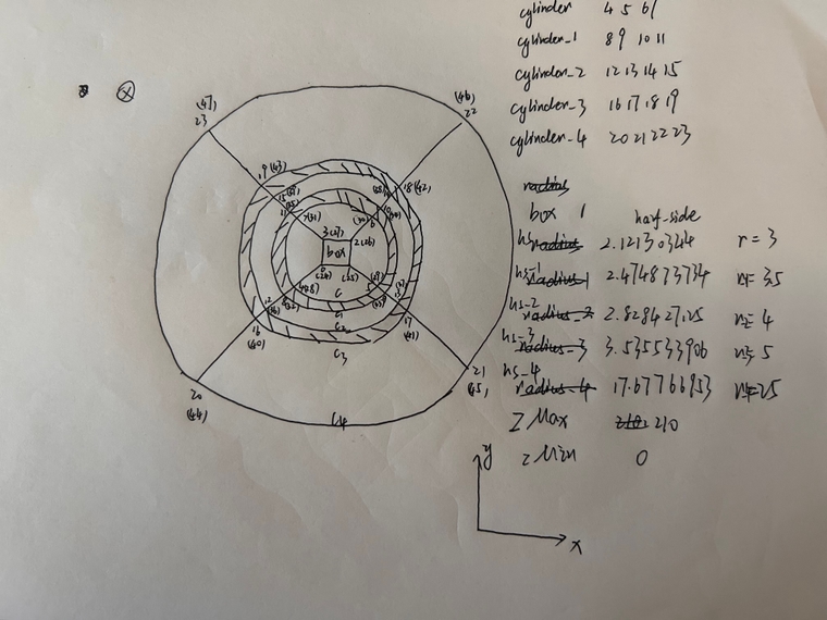

    我的几何结构大概是几个同心圆柱,同心圆柱的底面如下图

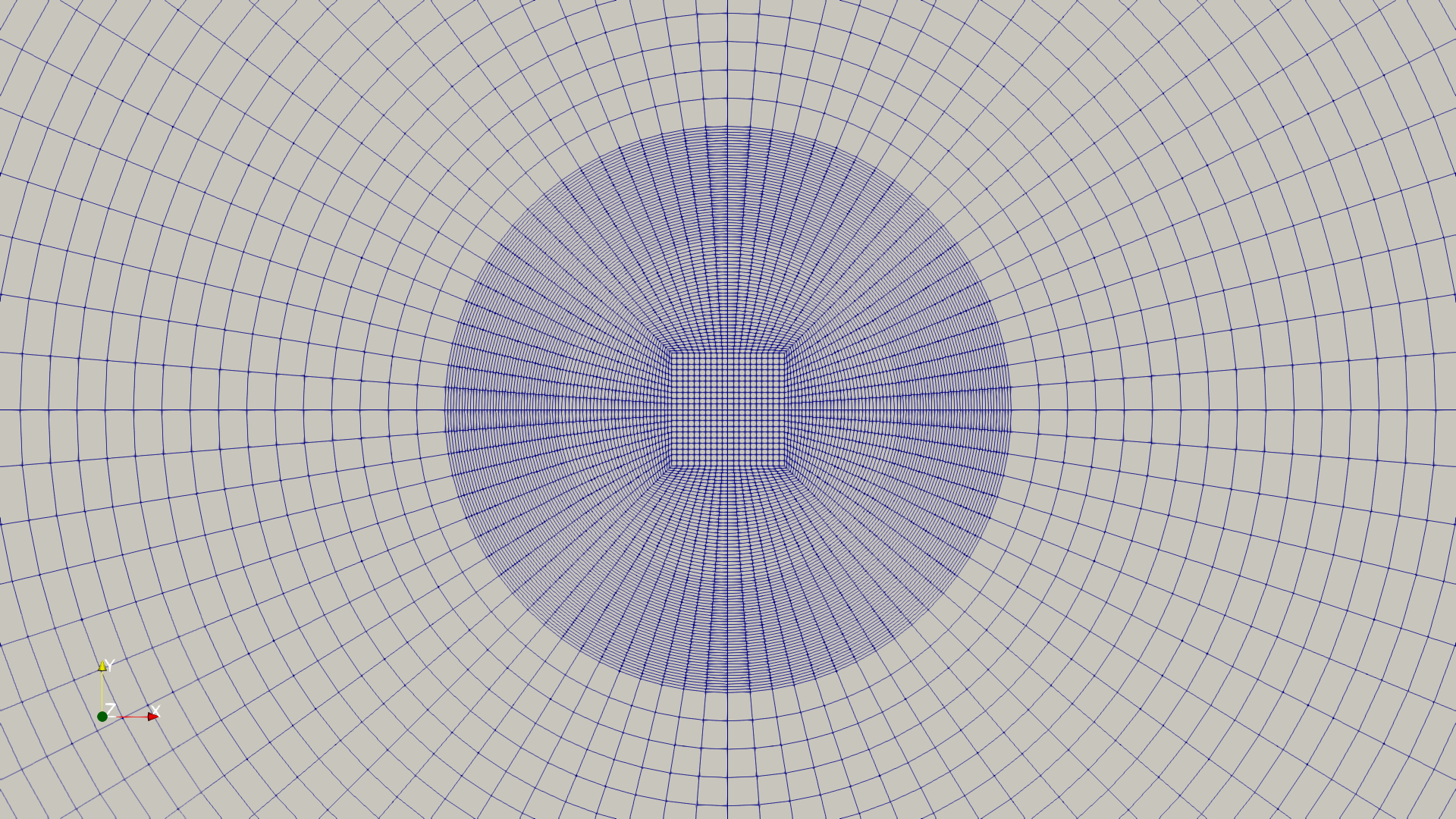

    看图,经过仔细检查,请把blockMeshDict文件中的blocks部分改成如下内容
        hex (0 1 2 3 24 25 26 27) ($nBox $nBox $nZ) simpleGrading (1 1 1)
        hex (0 4 5 1 24 28 29 25) ($nR $nBox $nZ) simpleGrading (1 1 1)
        hex (1 5 6 2 25 29 30 26) ($nR $nBox $nZ) simpleGrading (1 1 1)
        hex (2 6 7 3 26 30 31 27) ($nR $nBox $nZ) simpleGrading (1 1 1)
        hex (3 7 4 0 27 31 28 24) ($nR $nBox $nZ) simpleGrading (1 1 1)
        hex (4 8 9 5 28 32 33 29) ($nR_1 $nBox $nZ) simpleGrading (1 1 1)
        hex (5 9 10 6 29 33 34 30) ($nR_1 $nBox $nZ) simpleGrading (1 1 1)
        hex (6 10 11 7 30 34 35 31) ($nR_1 $nBox $nZ) simpleGrading (1 1 1)
        hex (7 11 8 4 31 35 32 28) ($nR_1 $nBox $nZ) simpleGrading (1 1 1)
        hex (8 12 13 9 32 36 37 33) ($nR_2 $nBox  $nZ) simpleGrading (1 1 1)
        hex (9 13 14 10 33 37 38 34) ($nR_2 $nBox $nZ) simpleGrading (1 1 1)
        hex (10 14 15 11 34 38 39 35) ($nR_2 $nBox $nZ) simpleGrading (1 1 1)
        hex (11 15 12 8 35 39 36 32) ($nR_2 $nBox $nZ) simpleGrading (1 1 1)
        hex (12 16 17 13 36 40 41 37) ($nR_3 $nBox  $nZ) simpleGrading (1 1 1)
        hex (13 17 18 14 37 41 42 38) ($nR_3 $nBox $nZ) simpleGrading (1 1 1)
        hex (14 18 19 15 38 42 43 39) ($nR_3 $nBox $nZ) simpleGrading (1 1 1)
        hex (15 19 16 12 39 43 40 36) ($nR_3 $nBox $nZ) simpleGrading (1 1 1)
        hex (16 20 21 17 40 44 45 41) ($nR_4 $nBox  $nZ) simpleGrading (1 1 1)
        hex (17 21 22 18 41 45 46 42) ($nR_4 $nBox $nZ) simpleGrading (1 1 1)
        hex (18 22 23 19 42 46 47 43) ($nR_4 $nBox  $nZ) simpleGrading (1 1 1)
        hex (19 23 20 16 43 47 44 40) ($nR_4 $nBox $nZ) simpleGrading (1 1 1)
    再次运行blockMesh即可获得如图所示网格,请注意匹配中心立方体和四周圆环体相邻部分的网格数量点关系
