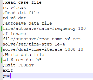

    各位大佬好!
    我是模拟小船在液面行驶(无浪、船静止)的一个情况,所用的journal文件内容如下:a2714af6-4001-4bef-9012-066cd057d0e6-image.png
    请问下该如何解决呢

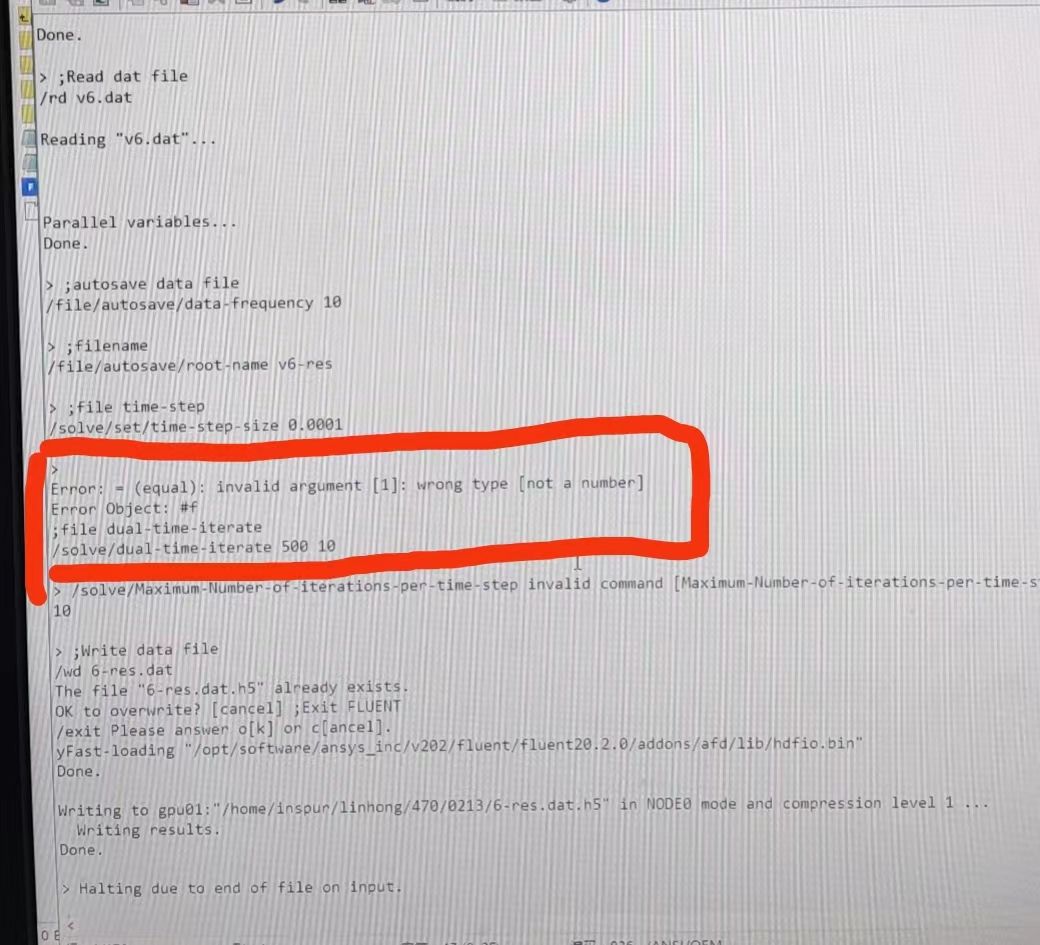

    这是完整的out文件内容:
    Reading journal file /home/inspur/linhong/470/0213/test.jou...
    > ;Read case file
    rc v6.cas
    WARNING: Rank:0 Machine gpu01 has 42 % of RAM filled with file buffer caches.
    This can cause potential performance issues. Please use -cflush flag to flush the cache.
    Multicore processors detected. Processor affinity set!
    Reading "v6.cas"...
    Buffering for file scan...
    10174406 mixed cells, zone 2864, binary.
    Warning: reading 12 partition grid onto 18 compute node machine;
             will auto partition.
    10174406 cell partition ids, zone 2864, 12 partitions, binary.
        4808 polygonal wall faces, zone 40, binary.
       85108 polygonal wall faces, zone 43, binary.
       97197 polygonal symmetry faces, zone 39, binary.
        8154 polygonal pressure-outlet faces, zone 42, binary.
        8119 polygonal pressure-inlet faces, zone 41, binary.
    33937451 mixed interior faces, zone 2866, binary.
    14103544 nodes, binary.
    14103544 node flags, binary.
    Warning: this is a single-precision solver.
    Building...
         mesh
    	auto partitioning mesh by Metis (fast),
    	distributing mesh
    		parts..................,
    		faces..................,
    		nodes..................,
    		cells..................,
            bandwidth reduction using Reverse Cuthill-McKee: 683158/20189 = 33.8381
         materials,
         interface,
         domains,
    	mixture
    	air
    	water
    	interaction
         zones,
    	domain  (air)
    	interior--domain  (air)
    	inlet  (air)
    	outlet  (air)
    	symmetry  (air)
    	hull  (air)
    	wall  (air)
    	domain  (water)
    	interior--domain  (water)
    	inlet  (water)
    	outlet  (water)
    	symmetry  (water)
    	hull  (water)
    	wall  (water)
    	wall
    	hull
    	symmetry
    	outlet
    	inlet
    	interior--domain
    	domain
         parallel,
    Note: 3d, double precision, pressure-based, VOF, SST k-omega, transient case read into
          3d, pressure-based, VOF, SST k-omega, transient solver.
    Done.
    Error: state/object/set-state:Rules not found for object type path: /Report/MeshMetricsSettings
    Error Object: ()
    > ;Read dat file
    rd v6.dat
    Reading "v6.dat"...
    Parallel variables...
    Done.
    > ;autosave data file
    file/autosave/data-frequency 1000
    > ;not overwrite
    file/autosave/overwrite-existing-files invalid command [overwrite-existing-files]
    no
    > ;filename
    file/autosave/root-name v6-res
    > solve/set/time-step 1e-4
    Error: = (equal): invalid argument [1]: wrong type [not a number]
    Error Object: #f
    solve/dual-time-iterate 50000 10
    > ;Write data file
    wd 6-res.dat
    Fast-loading "/opt/software/ansys_inc/v202/fluent/fluent20.2.0/addons/afd/lib/hdfio.bin"
    Done.
    Writing to gpu01:"/home/inspur/linhong/470/0213/6-res.dat.h5" in NODE0 mode and compression level 1 ...
      Writing results.
    Done.
    > ;Exit FLUENT
    exit
  • G 离线
    G 离线
    gemini
    服务器的Fluent版本跟调试用的一致吗?
    有条件的话可以在服务器上试一下/solve/set/ts命令
    体 1 条回复 最后回复
  • 体 离线
    体 离线
    体育CAEer
    在 中回复了 gemini 最后由 编辑
    @gemini 谢谢您,服务fluent版本跟调试用的是一致的,我去试试修改成您说的这样
