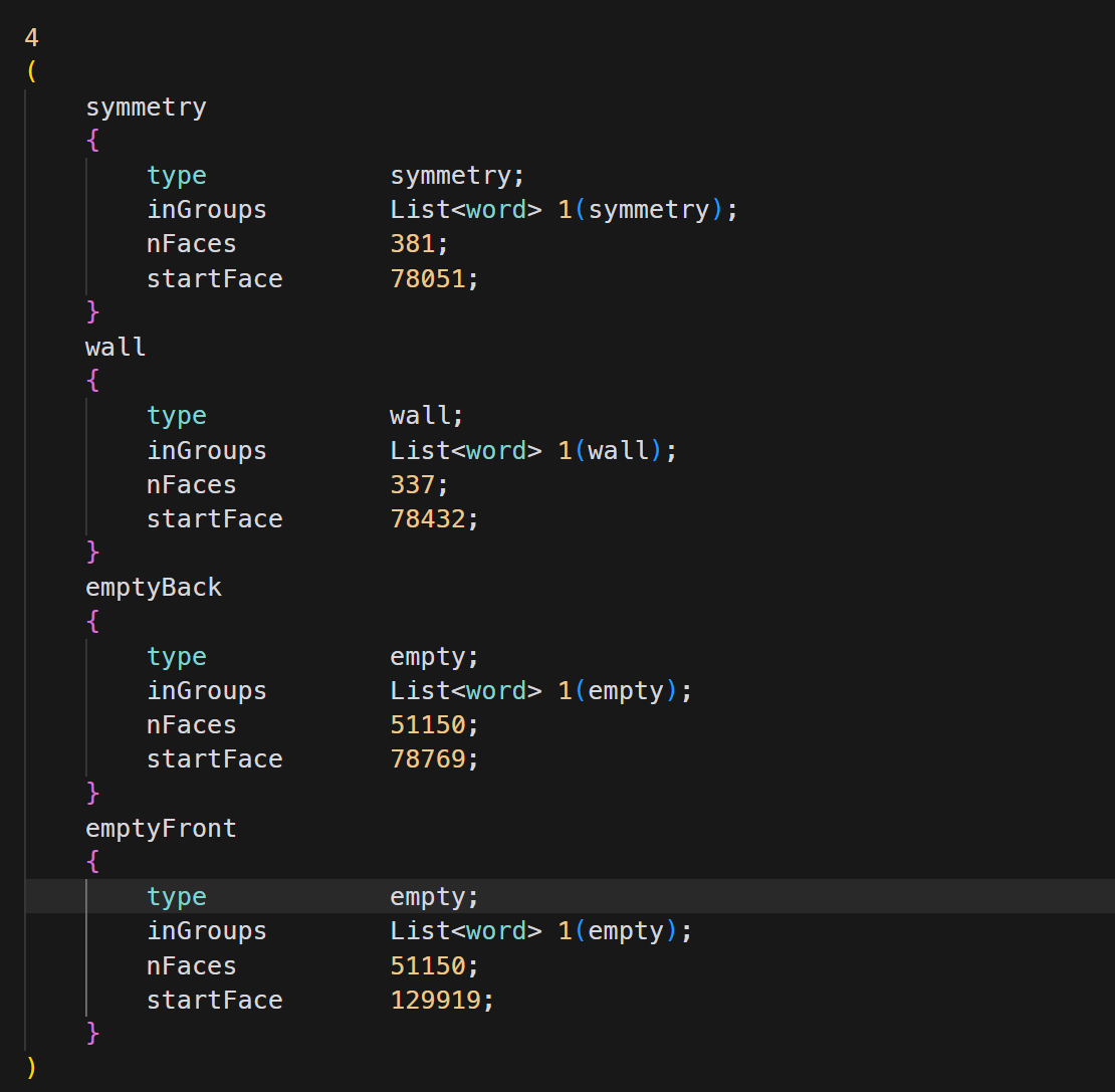

    OpenFOAM小白,我在STAR-CCM+绘制网格完网格,用ccm26ToFoam转换到OpenFOAM中。
    默认的的boundary类型如下,checkMesh是没有问题的

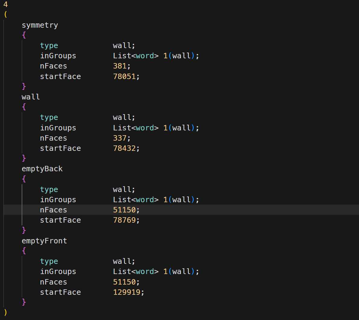

    我把boundary修改成下面之后,checkMesh出现了如下错误,望各位大佬帮忙看看。

    ice_flow
    1.我猜是symmetry这个边界条件,试一下改成wall,然后在0文件夹里自己定义上下的slip边界条件。openfoam会对生成的网格编号进行检查,外部软件的网格节点编号和blockMesh的逻辑不一样。
    2.可能是前后的empty边界问题,你可以在starccm里生成3D网格后,重新在openfoam里extrude来生成前后empty边界
    类似这样
    constructFrom patch;
    sourceCase "../w3-d_hc1-3";
    sourcePatches (symFront);
    // If construct from patch: patch to use for back (can be same as sourcePatch)
    exposedPatchName symBack;
    // Flip surface normals before usage. Valid only for extrude from surface or
    // patch.
    flipNormals false;
    //- Linear extrusion in point-normal direction
    extrudeModel linearNormal;
    nLayers 1;
    expansionRatio 1.0;
    linearNormalCoeffs
    thickness 1;
    // Do front and back need to be merged? Usually only makes sense for 360
    // degree wedges.
    mergeFaces false; //true;
    // Merge small edges. Fraction of bounding box.
    mergeTol 0;
