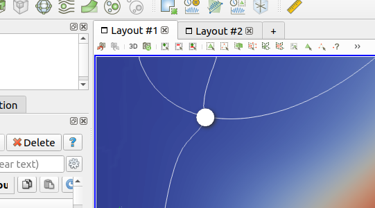

 openfoam监测数据openfoam或者paraview能不能监测两个等值线交点上值随时间变化啊?就比如下面这个图是两个contour线,先找到交点位置,然后在看这个交点位置的其他值。

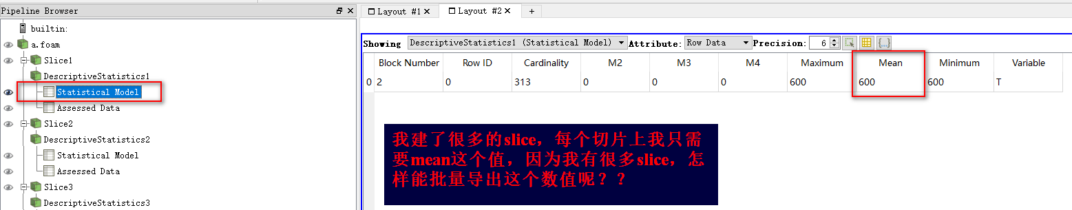

 paraview批量保存descriptiveStatistics的数据@氕氘-川 批量保存的脚本老报错: ERROR: In C:\bbd\df0abce0\build\paraview\src\paraview\ParaViewCore\VTKExtensions\Default\vtkCSVWriter.cxx, line 82
 vtkCSVWriter (000001F6DAFC08C0): Unable to open file: /-0.1150.csv
 vtkCSVWriter (000001F6DAFCC8C0): Unable to open file: /-0.0650.csv
 ...这是我的脚本:
 import numpy as np
 from paraview import numpy_support as ns
 import paraview as pv
 import paraview.simple as psafoam = FindSource('a.foam') for y in np.arange(-0.115,0.115,0.05): # Make a cut of the wing to have a local 2D profile Slice1 = Slice( Input=afoam ) Slice1.SliceType = "Plane" Slice1.Triangulatetheslice = 0 Slice1.SliceOffsetValues = [0.0] Slice1.SliceType.Origin = [0.0, y, 0.0] Slice1.SliceType.Normal = [0.0, 1.0, 0.0] descriptiveStatistics1 = DescriptiveStatistics(Slice1) descriptiveStatistics1.VariablesofInterest = ['T'] descriptiveStatistics1.AttributeMode = 0 Render() writer = CreateWriter(str(y)+".csv",OutputPort(descriptiveStatistics1, 1)) writer.FieldAssociation = "Cells" writer.UpdatePipeline() del writer #SaveData(str(y)+".csv", proxy=OutputPort(descriptiveStatistics1, 1), FieldAssociation='Cells') descriptiveStatistics1.UpdatePipeline()
 paraview批量保存descriptiveStatistics的数据大家好,我切了很多slice求每个切片上平均值,现在求出来后,因为只需要mean这个值,我怎样可以批量导出这个数值?
 这是我保存的方式:
 Render()
 writer = CreateWriter(str(y)+".csv"descriptiveStatistics1)
 writer.FieldAssociation = "Points"
 del writer
 但是这样保存会说writer.FieldAssociation = "Points"里面的points不对,然后我去了之后就会报错。
