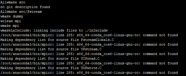

OpenFOAM8安装出错 -
OpenFOAM8安装出错@李东岳 Anaconda是一个打包的集合,里面预装好了conda、某个版本的python、众多packages、科学计算工具等,是Python的一种发行版。
OpenFOAM8安装出错@dawei 卸载anaconda后不再提示错误,编译过程提示新的错误:
/usr/bin/ld.bfd: warning: libOpenFOAM.so, needed by /home/hpctest/OpenFOAM/OpenFOAM-8/platforms/linux64GccDPInt32Opt/lib/libfiniteVolume.so, not found (try using -rpath or -rpath-link) /usr/bin/ld.bfd: warning: libtriSurface.so, needed by /home/hpctest/OpenFOAM/OpenFOAM-8/platforms/linux64GccDPInt32Opt/lib/libfiniteVolume.so, not found (try using -rpath or -rpath-link) /usr/bin/ld.bfd: warning: libsurfMesh.so, needed by /home/hpctest/OpenFOAM/OpenFOAM-8/platforms/linux64GccDPInt32Opt/lib/libmeshTools.so, not found (try using -rpath or -rpath-link) /usr/bin/ld.bfd: warning: libfileFormats.so, needed by /home/hpctest/OpenFOAM/OpenFOAM-8/platforms/linux64GccDPInt32Opt/lib/libmeshTools.so, not found (try using -rpath or -rpath-link) /usr/bin/ld.bfd: warning: libextrudeModel.so, needed by /home/hpctest/OpenFOAM/OpenFOAM-8/platforms/linux64GccDPInt32Opt/lib/libdynamicMesh.so, not found (try using -rpath or -rpath-link) /usr/bin/ld.bfd: warning: libmomentumTransportModels.so, needed by /home/hpctest/OpenFOAM/OpenFOAM-8/platforms/linux64GccDPInt32Opt/lib/libatmosphericModels.so, not found (try using -rpath or -rpath-link) /usr/bin/ld.bfd: warning: libincompressibleMomentumTransportModels.so, needed by /home/hpctest/OpenFOAM/OpenFOAM-8/platforms/linux64GccDPInt32Opt/lib/libatmosphericModels.so, not found (try using -rpath or -rpath-link) /usr/bin/ld.bfd: warning: libincompressibleTransportModels.so, needed by /home/hpctest/OpenFOAM/OpenFOAM-8/platforms/linux64GccDPInt32Opt/lib/libatmosphericModels.so, not found (try using -rpath or -rpath-link) /usr/bin/ld.bfd: warning: libfvOptions.so, needed by /home/hpctest/OpenFOAM/OpenFOAM-8/platforms/linux64GccDPInt32Opt/lib/libatmosphericModels.so, not found (try using -rpath or -rpath-link) -
OpenFOAM8安装出错安装过程提示以下错误是什么原因?
