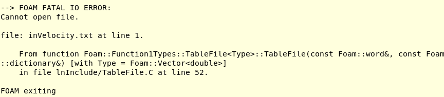

  • 边界条件tableFile读取错误问题
    H Hope
    模拟二维大气边界层流动,入口添加ESDU的对数律剖面时,采用如下方式定义,
    INLET
           type            fixedProfile;
       profile 	tableFile;
       profileCoeffs
               nHeaderLine         0;          // Number of header lines
               refColumn           1;          // Reference column index
               componentColumns    (1);    // Component column indices
               separator           " ";        // Optional (defaults to ",")
               mergeSeparators     no;         // Merge multiple separators
               file                "inVelocity.txt";//"inletProfiles/inVelocity.csv";
               outOfBounds         clamp;      // Optional out-of-bounds handling
               interpolationScheme linear;     // Optional interpolation scheme
           direction        (0 1 0);
           origin           0;
    运行simpleFoam时,提示如下错误
    inVelocity.txt文件为
    0.899251
    3.78464
    3.88646
    3.96812
    4.03721
    4.09802
    4.15319
    4.20449
    4.25314
    4.30008
    4.34601
    4.39149
    4.43702
    4.483
    4.5298
    4.57773
    4.62706
    4.67807
    4.73099
    4.78608
    4.84357
    4.90368
    4.96665
    5.03268
    5.10199
    5.17476
    5.25119
    5.33143
    5.41563
    5.50394
    5.59645
    5.69327
    5.79447
    5.90012
    6.01023
    不知道问题在哪里?还请各位指教
