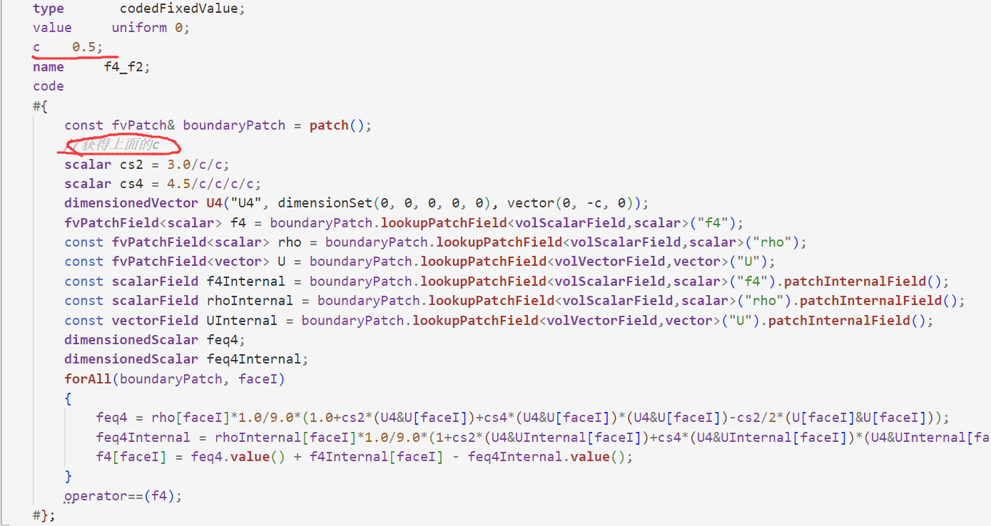

    J Junren Hou
    我想在codedFixedValue中的获得主程序中的常量,比如下面这个边界条件里。
            type       codedFixedValue;
            value     uniform 0;
            name     f4_f2;
            code
                const fvPatch& boundaryPatch = patch();
                scalar c = 0.5;
                scalar cs2 = 3.0/c/c;
                scalar cs4 = 4.5/c/c/c/c;
                dimensionedVector U4("U4", dimensionSet(0, 0, 0, 0, 0), vector(0, -c, 0));
                fvPatchField<scalar> f4 = boundaryPatch.lookupPatchField<volScalarField,scalar>("f4");
                const fvPatchField<scalar> rho = boundaryPatch.lookupPatchField<volScalarField,scalar>("rho");
                const fvPatchField<vector> U = boundaryPatch.lookupPatchField<volVectorField,vector>("U");
                const scalarField f4Internal = boundaryPatch.lookupPatchField<volScalarField,scalar>("f4").patchInternalField();
                const scalarField rhoInternal = boundaryPatch.lookupPatchField<volScalarField,scalar>("rho").patchInternalField();
                const vectorField UInternal = boundaryPatch.lookupPatchField<volVectorField,vector>("U").patchInternalField();
                dimensionedScalar feq4;
                dimensionedScalar feq4Internal;
                forAll(boundaryPatch, faceI)
                    feq4 = rho[faceI]*1.0/9.0*(1.0+cs2*(U4&U[faceI])+cs4*(U4&U[faceI])*(U4&U[faceI])-cs2/2*(U[faceI]&U[faceI]));
                    feq4Internal = rhoInternal[faceI]*1.0/9.0*(1+cs2*(U4&UInternal[faceI])+cs4*(U4&UInternal[faceI])*(U4&UInternal[faceI])-cs2/2*(UInternal[faceI]&UInternal[faceI]));
                    f4[faceI] = feq4.value() + f4Internal[faceI] - feq4Internal.value();
                operator==(f4);
    c在求解器里通过transportProperties进行了定义,我想获得它。
    dimensionedScalar c
        "c",
        dimensionSet(0, 0, 0, 0, 0, 0, 0),
        transportProperties
    如果不行,退而求其次,能否在边界条件里,通过设置c value;来获得呢,这样就不用每次改c值都得重新编译边界条件了。就像下面这个图里的样子
