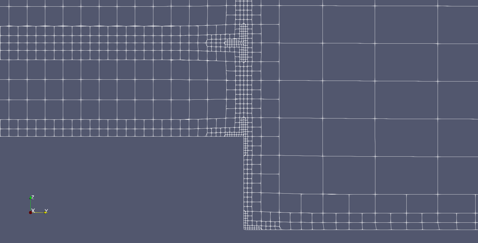

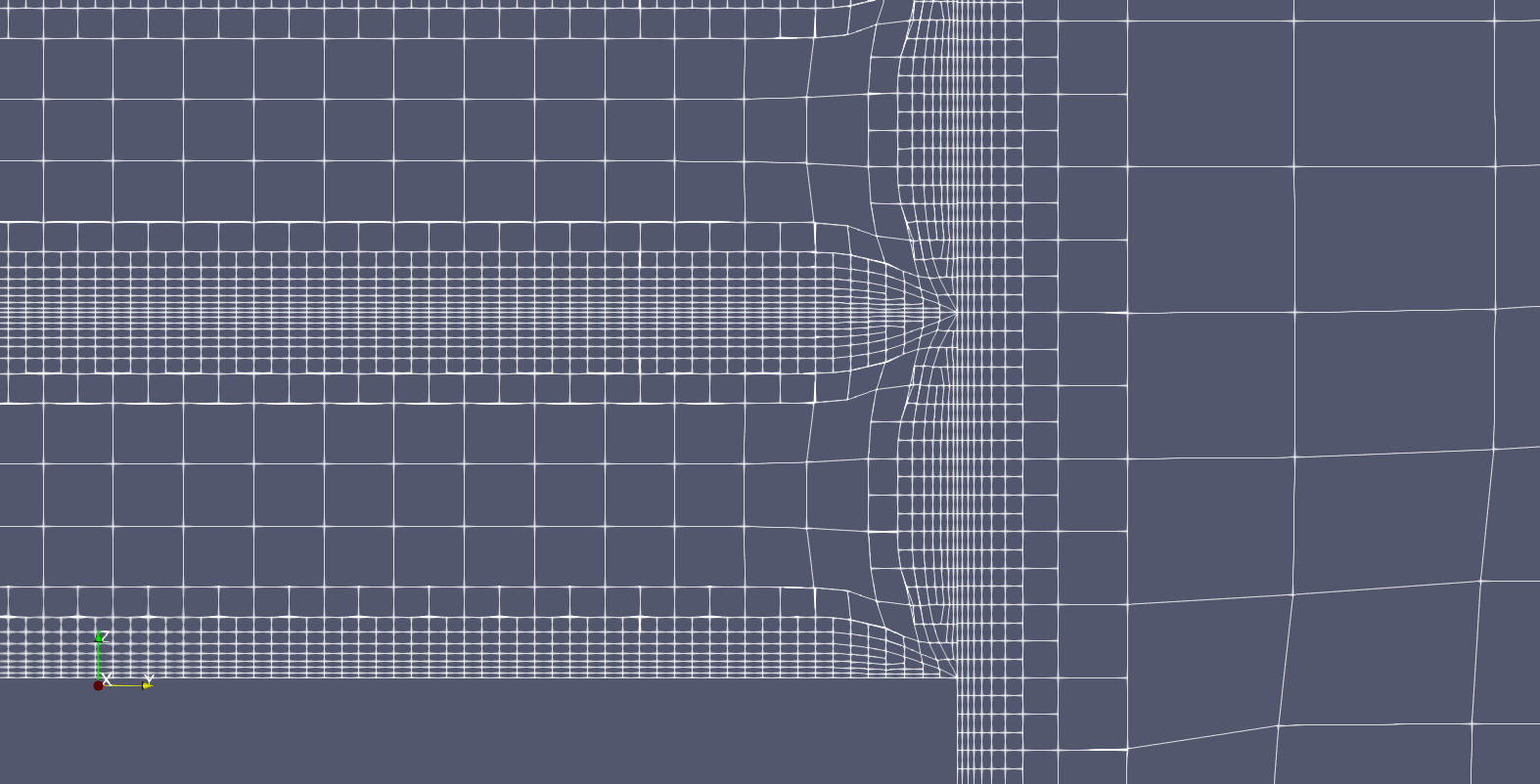

  • snappyHexMesh的加密以及在直角处的边界层生成问题
    S studentTan
    求教各位大佬,我在使用snappyHexMeshDict一个建筑的室内外网格进行加密的时候遇到了两个问题,首先是想通过控制level从(3,3)到(4,4)在壁面附近对网格进行加密,但是画出来的网格只有在拐角的地方有加密,平面区域没变;
    没办法只能通过增加边界层来加密,但是在直角处生成的边界层网格看着不是均匀的正六面体网格
    虽然checkMesh显示的网格质量还OK,但是有没有进一步提高的方法
    castellatedMesh    true;
    snap		        true;
    addLayers		false;
    geometry
        case.stl
            type		triSurfaceMesh;
            name		case;
            regions
              geo 0
               castellatedMeshControls
                   maxLocalCells		1000000;
                   maxGlobalCells		8000000;
                   minRefinementCells		10;
                   maxLoadUnbalance		0.10;
                   nCellsBetweenLevels		1;
                   features		({file "case.eMesh"; level 3;} );
                   refinementSurfaces
                       case
                           level		(3 3);
                           regions
                              geo1
                                  level		(3 3);
        resolveFeatureAngle		60;
        refinementRegions{}
        locationInMesh		(0.0 200.0 220.0);
        allowFreeStandingZoneFaces		true;
    snapControls
        nSmoothPatch		5;
        nSmoothInternal		5;
        tolerance		2;
        nSolveIter		100;
        nRelaxIter		8;
        nFeatureSnapIter		10;
        nFaceSplitInterval		5;
        extractFeaturesRefineLevel		true;
        explicitFeatureSnap		true;
    addLayersControls
        relativeSizes		false;
        layers
            geo0
                nSurfaceLayers		3;
                expansionRatio		1.2;
        expansionRatio		1.2;
        firstLayerThickness		0.015;
        minThickness		0.015;
        nGrow		0;
        featureAngle		180;
        slipFeatureAngle		75;
        nRelaxIter		5;
        nsmoothSurfaceNormals		1;
        nSmoothThickness		10;
        nSmoothNormals		3;
        maxFaceThicknessRatio		0.5;
        maxThicknessToMedialRatio		0.3;
        minMedianAxisAngle		130;
        nBufferCellsNoExtrude		0;
        nLayerIter		50;
        nRelaxedIter		20;
    meshQualityControls
        maxNonOrtho		50;
        maxBoundarySkewness		4;
        maxInternalSkewness		4;
        maxConcave		80;
        minFlatness		0.5;
        minVol		1e-13;
        minTetQuality		1e-15;
        minArea		-1;
        minTwist		0.02;
        minDeterminant		1e-30;
        minFaceWeight		1e-30;
        maxFaceThicknessRatio		0.3;
        minVolRatio		1e-30;
        minTriangleTwist		-1;
        nSmoothScale		4;
        errorReduction		0.75;
        relaxed
            maxNonOrtho		60;
