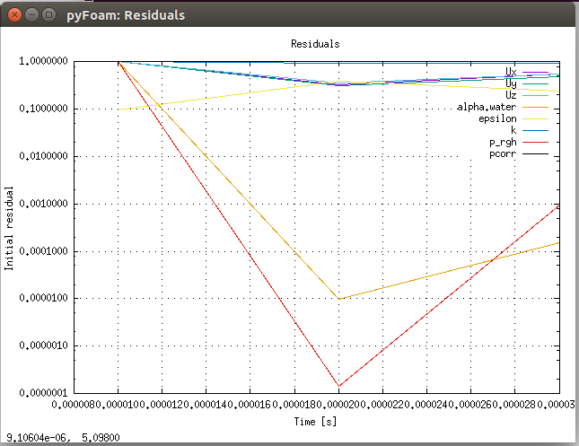

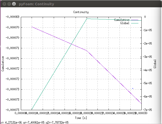

  • 用InterPhaseChangeDyMFoam求解器计算崩溃
    W wyf12344445
    各位老师同学好。本人最近在用InterPhaseChangeDyMFoam计算旋转机械(介质是水)的空化问题,边界条件是入口速度fixedValue ,压力totalpressure;出口速度inletOutlet,压力fixedFluxPressure,湍流采用标准K-e模型,额定的转速是303rad/s,入口段直径0.125m,速度给定5m/s,给定的k和epsilon初值分别是0.0284和0.09,时间步长设定1e-5,网格40W左右(非结构),用AMI连接域。在计算几步后就回出现崩溃,但是通过大幅度缩小时间步长和减少转速(大概到50rad)可以正常收敛,但是这两者都不太能接受。所以想寻求各位大神帮忙看看有没有更好的方法能稳定计算,或者如果是我的设置有问题也欢迎指正~~~~附上log和pyfoam的图

    Time = 1e-05
    PIMPLE: Iteration 1
    AMI: Creating addressing and weights between 589 source faces and 754 target faces
    AMI: Patch source sum(weights) min/max/average = 0.99691, 1, 0.999455
    AMI: Patch target sum(weights) min/max/average = 0.990625, 1, 0.999455
    AMI: Creating addressing and weights between 2752 source faces and 2836 target faces
    AMI: Patch source sum(weights) min/max/average = 0.999971, 1.00012, 1.00004
    AMI: Patch target sum(weights) min/max/average = 0.999955, 1.00011, 1.00004
    Execution time for mesh.update() = 0.28 s
    GAMG:  Solving for pcorr, Initial residual = 1, Final residual = 0.0046122, No Iterations 7
    time step continuity errors : sum local = 7.2582e-05, global = -6.94718e-05, cumulative = -6.94718e-05
    smoothSolver:  Solving for alpha.water, Initial residual = 0.999973, Final residual = 1.1325, No Iterations 10
    Phase-1 volume fraction = 1  Min(alpha.water) = 1  Max(alpha.water) = 1
    MULES: Correcting alpha.water
    Liquid phase volume fraction = 1  Min(alpha.water) = 1  Max(alpha.water) = 1
    smoothSolver:  Solving for Ux, Initial residual = 1, Final residual = 0.00343267, No Iterations 1
    smoothSolver:  Solving for Uy, Initial residual = 1, Final residual = 0.00357127, No Iterations 1
    smoothSolver:  Solving for Uz, Initial residual = 1, Final residual = 4.53115e-06, No Iterations 1
    GAMG:  Solving for p_rgh, Initial residual = 1, Final residual = 9.27694e-10, No Iterations 48
    PIMPLE: Iteration 2
    smoothSolver:  Solving for alpha.water, Initial residual = 1, Final residual = 4.3514e-09, No Iterations 3
    Phase-1 volume fraction = 0.979984  Min(alpha.water) = 0.821031  Max(alpha.water) = 1
    Liquid phase volume fraction = 0.979982  Min(alpha.water) = 0.820777  Max(alpha.water) = 1
    smoothSolver:  Solving for Ux, Initial residual = 0.152882, Final residual = 0.000456751, No Iterations 1
    smoothSolver:  Solving for Uy, Initial residual = 0.158655, Final residual = 0.000456774, No Iterations 1
    smoothSolver:  Solving for Uz, Initial residual = 0.173638, Final residual = 0.000499279, No Iterations 1
    GAMG:  Solving for p_rgh, Initial residual = 0.00387877, Final residual = 9.67937e-10, No Iterations 8
    PIMPLE: Iteration 3
    smoothSolver:  Solving for alpha.water, Initial residual = 0.000217683, Final residual = 5.3264e-11, No Iterations 2
    Phase-1 volume fraction = 0.995947  Min(alpha.water) = 0.351358  Max(alpha.water) = 1
    Liquid phase volume fraction = 0.995942  Min(alpha.water) = 0.345137  Max(alpha.water) = 1
    smoothSolver:  Solving for Ux, Initial residual = 0.0528343, Final residual = 6.27726e-07, No Iterations 3
    smoothSolver:  Solving for Uy, Initial residual = 0.0567381, Final residual = 7.23559e-07, No Iterations 3
    smoothSolver:  Solving for Uz, Initial residual = 0.120368, Final residual = 8.2518e-08, No Iterations 4
    GAMG:  Solving for p_rgh, Initial residual = 3.49149e-06, Final residual = 5.80041e-10, No Iterations 5
    smoothSolver:  Solving for epsilon, Initial residual = 0.0986499, Final residual = 5.16839e-07, No Iterations 4
    smoothSolver:  Solving for k, Initial residual = 1, Final residual = 1.29045e-07, No Iterations 6
    ExecutionTime = 8.23 s  ClockTime = 9 s
    Courant Number mean: 0.0197059 max: 5.41516
    Time = 2e-05
    PIMPLE: Iteration 1
    AMI: Patch source sum(weights) min/max/average = 0.996998, 1, 0.999472
    AMI: Patch target sum(weights) min/max/average = 0.990859, 1, 0.999472
    AMI: Patch source sum(weights) min/max/average = 0.999977, 1.00014, 1.00004
    AMI: Patch target sum(weights) min/max/average = 0.999968, 1.00012, 1.00004
    Execution time for mesh.update() = 0.26 s
    GAMG:  Solving for pcorr, Initial residual = 1, Final residual = 0.00504073, No Iterations 3
    time step continuity errors : sum local = 0.000188015, global = -1.15051e-06, cumulative = -7.06224e-05
    smoothSolver:  Solving for alpha.water, Initial residual = 9.67477e-06, Final residual = 6.18883e-11, No Iterations 2
    Phase-1 volume fraction = 0.995772  Min(alpha.water) = 0.211932  Max(alpha.water) = 1
    Liquid phase volume fraction = 0.995769  Min(alpha.water) = 0.174408  Max(alpha.water) = 1
    smoothSolver:  Solving for Ux, Initial residual = 0.325971, Final residual = 0.0183609, No Iterations 1
    smoothSolver:  Solving for Uy, Initial residual = 0.309661, Final residual = 0.0165613, No Iterations 1
    smoothSolver:  Solving for Uz, Initial residual = 0.351942, Final residual = 0.0299024, No Iterations 1
    GAMG:  Solving for p_rgh, Initial residual = 1.43572e-07, Final residual = 7.23286e-10, No Iterations 5
    PIMPLE: Iteration 2
    smoothSolver:  Solving for alpha.water, Initial residual = 0.0155352, Final residual = 2.2274e-09, No Iterations 3
    Phase-1 volume fraction = 0.952704  Min(alpha.water) = 0.277133  Max(alpha.water) = 1
    Liquid phase volume fraction = 0.952698  Min(alpha.water) = 0.228159  Max(alpha.water) = 1.00002
    smoothSolver:  Solving for Ux, Initial residual = 0.104737, Final residual = 0.00347544, No Iterations 2
    smoothSolver:  Solving for Uy, Initial residual = 0.0999211, Final residual = 0.00465959, No Iterations 2
    smoothSolver:  Solving for Uz, Initial residual = 0.18458, Final residual = 0.0128277, No Iterations 2
    GAMG:  Solving for p_rgh, Initial residual = 0.0234743, Final residual = 7.77366e-10, No Iterations 5
    PIMPLE: Iteration 3
    smoothSolver:  Solving for alpha.water, Initial residual = 0.00178812, Final residual = 5.32355e-09, No Iterations 2
    Phase-1 volume fraction = 0.985629  Min(alpha.water) = 0.0661184  Max(alpha.water) = 1
    Liquid phase volume fraction = 0.985616  Min(alpha.water) = 0.0661918  Max(alpha.water) = 1.00001
    smoothSolver:  Solving for Ux, Initial residual = 0.0821993, Final residual = 9.95813e-07, No Iterations 383
    smoothSolver:  Solving for Uy, Initial residual = 0.092795, Final residual = 9.84964e-07, No Iterations 401
    smoothSolver:  Solving for Uz, Initial residual = 0.174958, Final residual = 9.94153e-07, No Iterations 455
    GAMG:  Solving for p_rgh, Initial residual = 0.00206972, Final residual = 3.9387e-10, No Iterations 6
    smoothSolver:  Solving for epsilon, Initial residual = 0.393518, Final residual = 8.58378e-07, No Iterations 27
    smoothSolver:  Solving for k, Initial residual = 0.951336, Final residual = 9.76279e-07, No Iterations 374
    ExecutionTime = 24.93 s  ClockTime = 25 s
    Courant Number mean: 0.0203512 max: 31.9041
    Time = 3e-05
    PIMPLE: Iteration 1
    AMI: Patch source sum(weights) min/max/average = 0.997111, 1, 0.999493
    AMI: Patch target sum(weights) min/max/average = 0.991164, 1, 0.999493
    AMI: Patch source sum(weights) min/max/average = 0.999987, 1.00015, 1.00004
    AMI: Patch target sum(weights) min/max/average = 0.999955, 1.00014, 1.00004
    Execution time for mesh.update() = 0.22 s
    GAMG:  Solving for pcorr, Initial residual = 1, Final residual = 0.00576691, No Iterations 3
    time step continuity errors : sum local = 0.000687359, global = -2.57908e-06, cumulative = -7.32014e-05
    smoothSolver:  Solving for alpha.water, Initial residual = 0.000155352, Final residual = 4.58115e-09, No Iterations 3
    Phase-1 volume fraction = 0.985431  Min(alpha.water) = 0.00232962  Max(alpha.water) = 1
    Liquid phase volume fraction = 0.985415  Min(alpha.water) = -0.0498938  Max(alpha.water) = 1.00005
    smoothSolver:  Solving for Ux, Initial residual = 0.556211, Final residual = 0.0456756, No Iterations 1
    smoothSolver:  Solving for Uy, Initial residual = 0.483701, Final residual = 0.0456852, No Iterations 1
    smoothSolver:  Solving for Uz, Initial residual = 0.54432, Final residual = 0.0380588, No Iterations 1
    GAMG:  Solving for p_rgh, Initial residual = 0.000953864, Final residual = 3.46933e-10, No Iterations 7
    PIMPLE: Iteration 2
    smoothSolver:  Solving for alpha.water, Initial residual = 7.33141e-05, Final residual = 3.27551e-09, No Iterations 3
    Phase-1 volume fraction = 0.985373  Min(alpha.water) = 0.00519769  Max(alpha.water) = 1
    Liquid phase volume fraction = 0.985357  Min(alpha.water) = -0.0226666  Max(alpha.water) = 1.00002
    smoothSolver:  Solving for Ux, Initial residual = 0.251887, Final residual = 0.0202833, No Iterations 1
    smoothSolver:  Solving for Uy, Initial residual = 0.190243, Final residual = 0.0150066, No Iterations 1
    smoothSolver:  Solving for Uz, Initial residual = 0.216529, Final residual = 0.0209459, No Iterations 1
    GAMG:  Solving for p_rgh, Initial residual = 2.22683e-06, Final residual = 4.46301e-10, No Iterations 1
    PIMPLE: Iteration 3
    smoothSolver:  Solving for alpha.water, Initial residual = 5.92958e-05, Final residual = 4.78988e-09, No Iterations 3
    Phase-1 volume fraction = 0.985322  Min(alpha.water) = 0.00340138  Max(alpha.water) = 1
    Liquid phase volume fraction = 0.985304  Min(alpha.water) = -0.0173934  Max(alpha.water) = 1.00005
    smoothSolver:  Solving for Ux, Initial residual = 0.300509, Final residual = 0.0025018, No Iterations 1000
